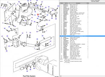

I have attached a picture of the fuel system parts. I am thinking that the problem lies in either #28 or #10. Does anyone have experience with either one of these parts?

I cant relay see it is there a purge valve in the breather tube going towards the filler cap.
