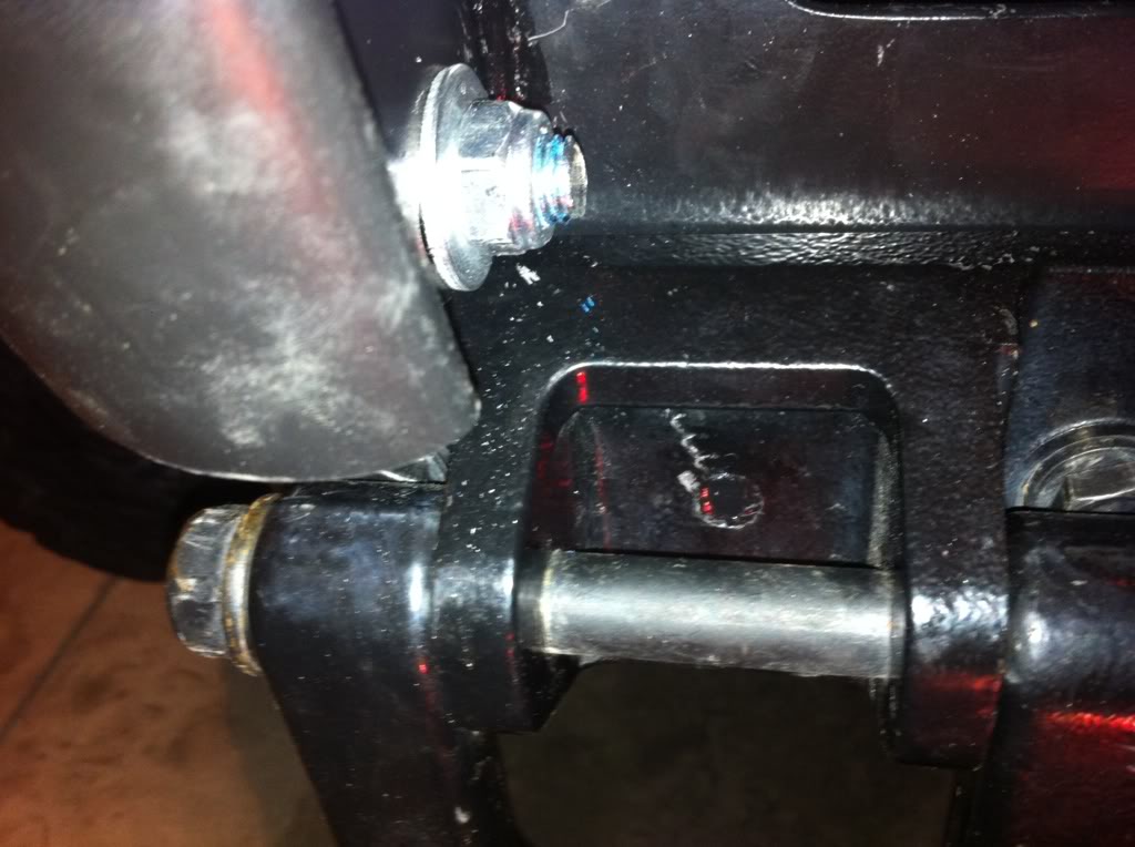

Hello everyone,
I ordered a grille guard off eBay and it requires the removal of the tow hooks from the frame to insert the bracket in between. I unbolted the tow hooks from the frame but I can't get them to budge. Is there another bolt on the inside of the bumper holding it? If so, how am i supposed to access it? Thanks for the help!

look close for a small fastener you missed, that u can throw away. been talked about here about once a quarter.

Yea, the fastener is a pain to get back in. I managed to do it, but it was pure luck I believe.

Where is this fastener you speak of?

There is a bolt on the back of the d hook brace. In process of drilling it out. Im not taking the full bumper removal route.

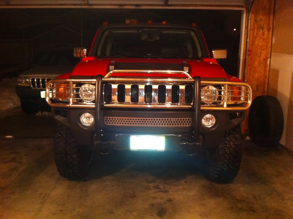

Got the job done. I just drilled out the bolts and filled the holes with black silicone. Hardly noticeable. Better than removing the whole bumper.

Wow that seemed like a lot of work. Mine came right out. Rig looks good!
