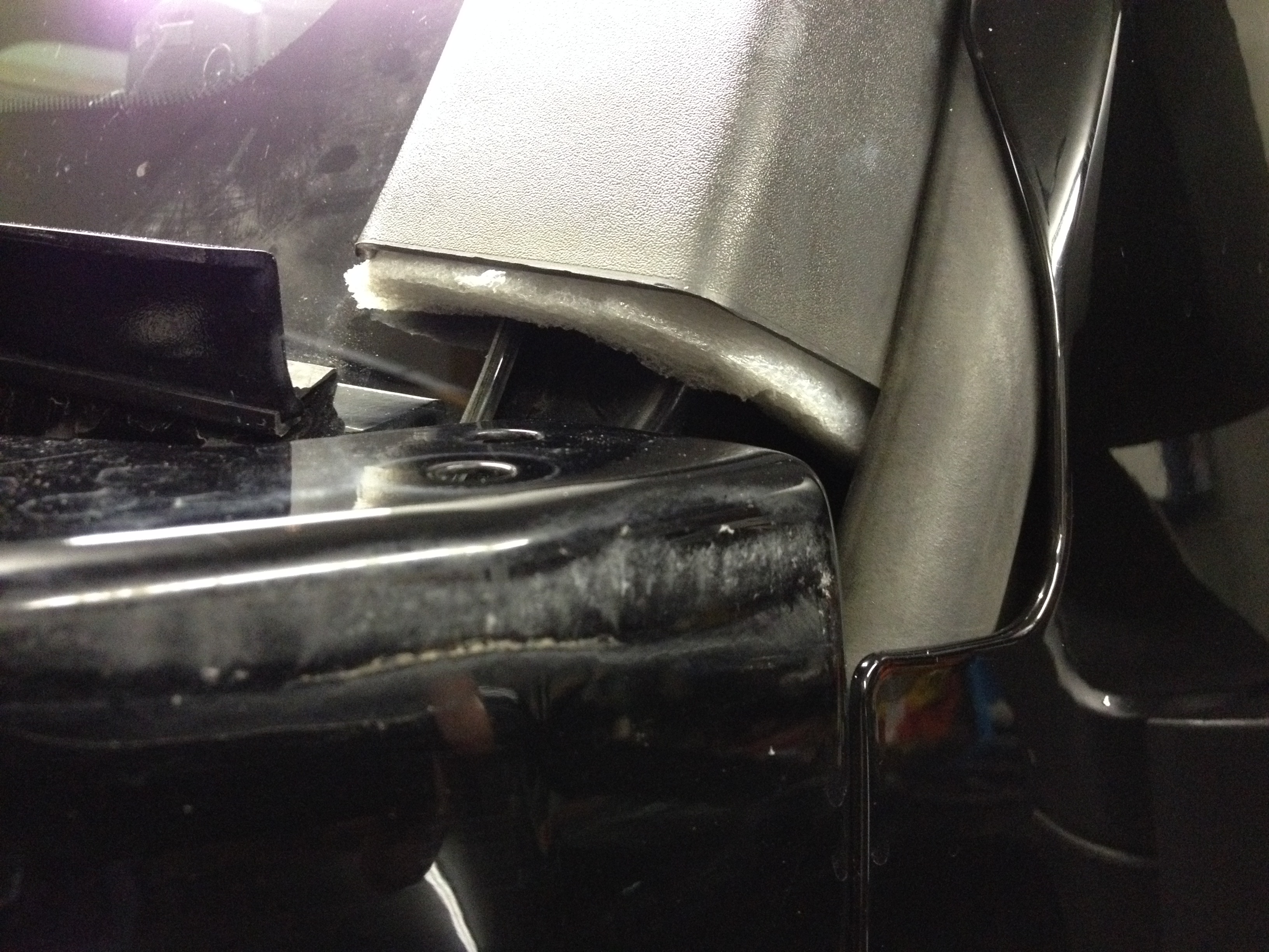

Here's what I found and fixed.

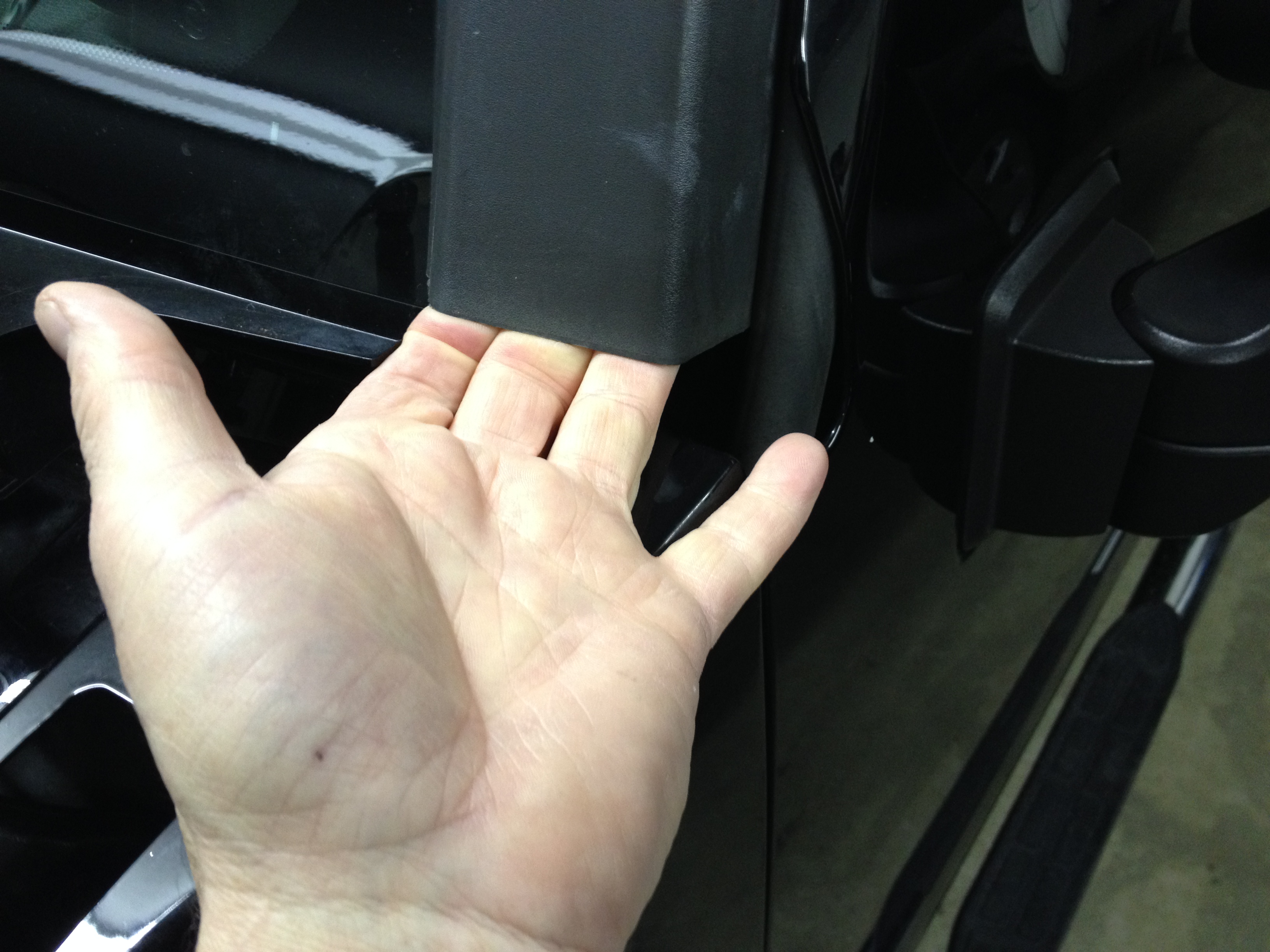

If you open the hood and take off the fender vent caps (the square things at the base of the A pillars) pull up on them and they un snap.
Look at the base of the A pillar cover, you can fit your fingers under there, THAT is where the air is going up and making the noise.

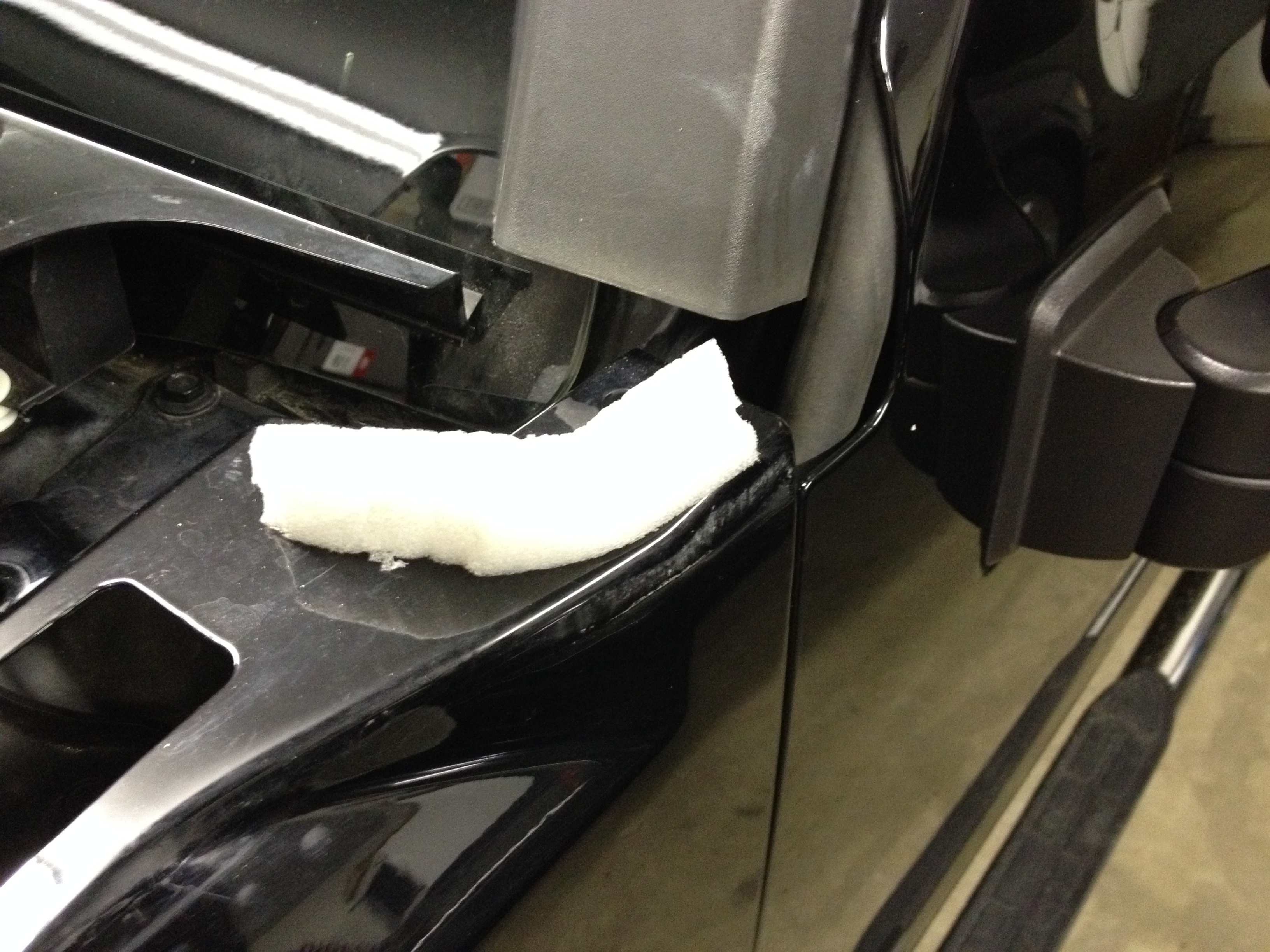

I had some closed cell foam I cut a 3/4" x 3/4' x @ 4" long piece and laid it under there to keep the wind out. (make it a snug fit)
PERFETCLY quiet again!!!
I think there were some foam seals in there and when the A Pillars were removed for the windshield replacement the seals were never put back in, if they were, not properly.
Fast and easy fix.

Here you go! The Pics!

Looks great ! Does that foam play ok with water? Wouldnt it get in there when we wash the truck or when it rains? Either way great fix, hate the annoying noise
Old Mar 2, 2016 | 11:59 AM
jonnieh3's Avatar
Joined: Sep 2010
Posts: 45
I used a closed cell foam it does not hold or absorb water.
I think it was out of an old life jacket.
I was concerned with that too. its not a perfect molded air tight fit so water can drain.
It just stops 95% of the air blowing up there. Very quiet now.
