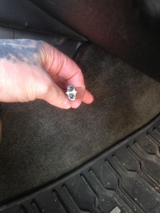

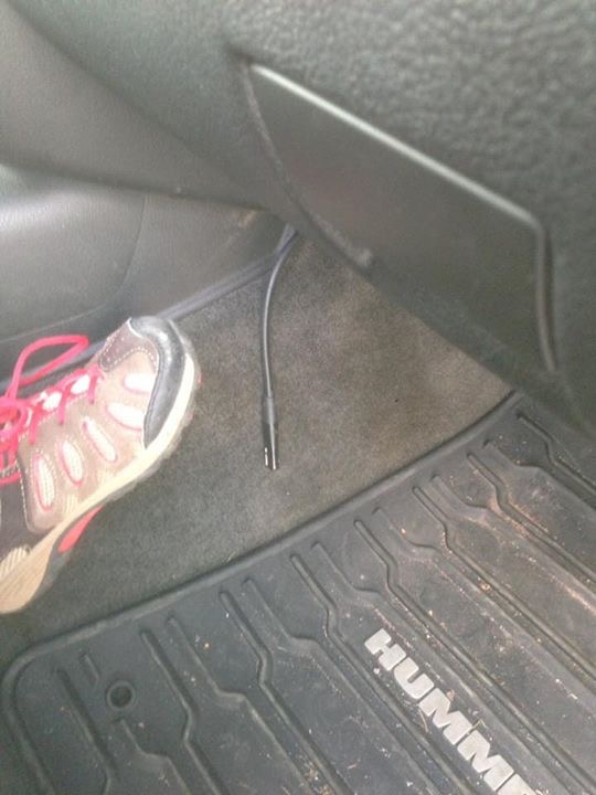

Final question , there is a cable that hangs loose in the passenger footwell, cab anyone shed some light on what it s for?
Need a pic of said wire...

Photo of said wire coming up .

One more pic of said loose cable

That almost looks like an external aux cable.

Cable does not appear to be factory. Trace it. I'm sure it is something a previous owner installed.
