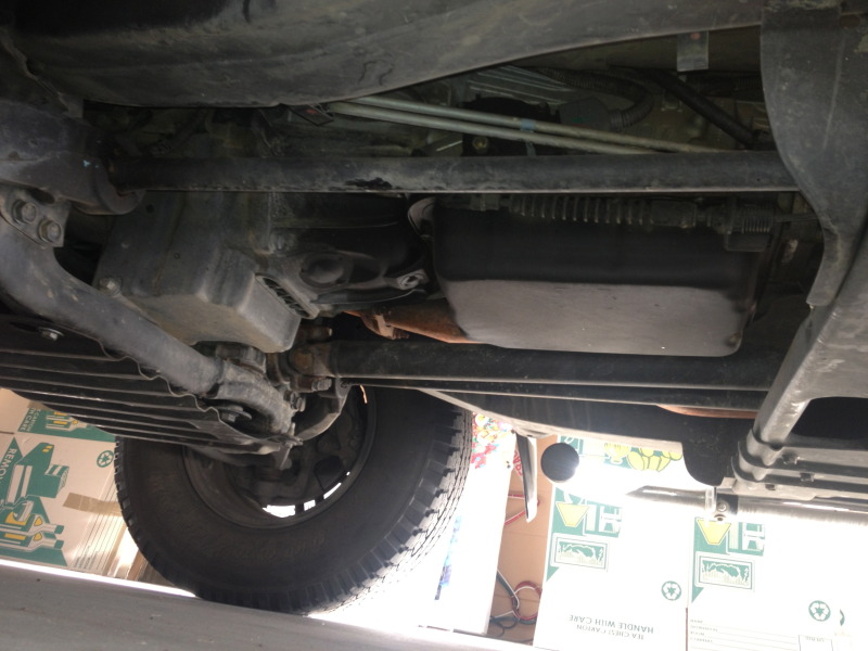

These are the only photos I have and should give you some idea, you can see no protection in the middle, and you can see the front bash plate, there is also a small plate that can be seen.

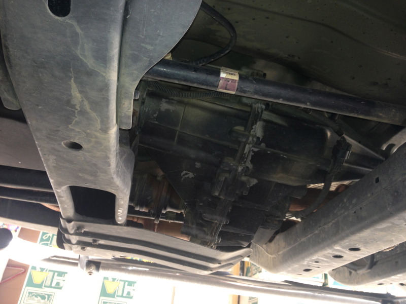

Here is the small plate:

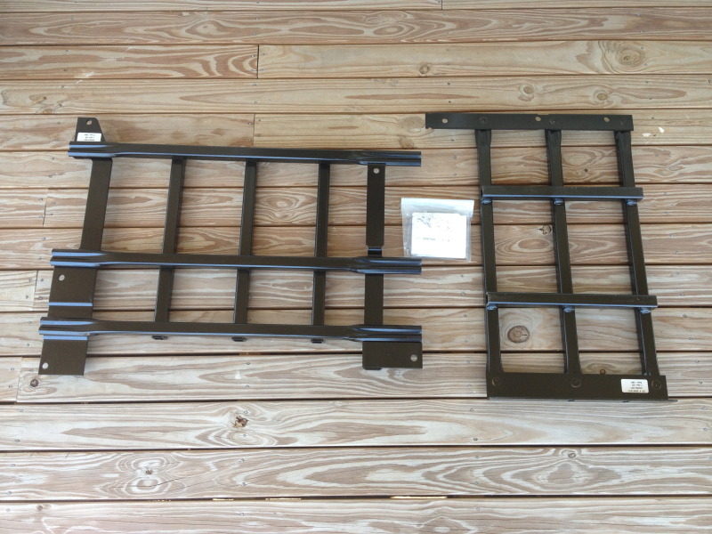

Here is the genuine GM underbody protection you can fit as an optional upgrade, picked this up on eBAy quite cheaply:

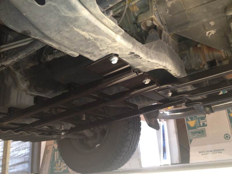

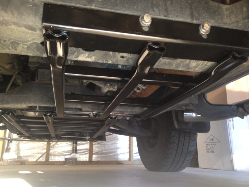

Here it is fitted:
