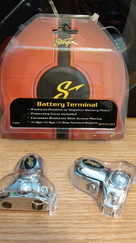

Talking They have arrived!
Stingers came today! Will head to Home Depot for the liquid tape and begin installation this afternoon!
Only thing left on my 2006 that puts fear in me is the Potential cylinder head issue, and bad U joints. May I ever be so lucky to avoid the cyclinder head problem!!
Old Oct 16, 2014 | 04:50 PM
Posts: 9,047
Nice! Secure the cables tight, then seal them.
Don't worry about the cyl head, just use top tier fuel and keep that tb,maf, & af clean. Using cheap fuel and not doing proper maintenance causes carbon deposits which damage the valves/seals!
