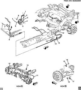

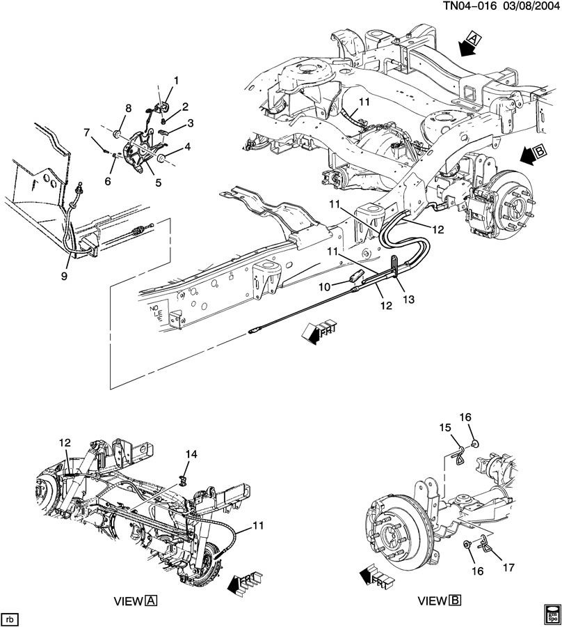

Its most likely a cable of which there are 3, one Attachment 26780from the foot-peddle to a junction-bracket which in-turn links to the LH & RH rear brakes.
If your peddle has dropped to the floor you can pull it back up by hand to stop the warning sounsd (CAUTION Your emergency brake won't work!)
As a tip, if one cable has broken then buy a pair and change both because sooner or later the other will fail.
You will find a 10mm open-ended wrench fits nicely over the cable "tangs" to help release them. A zip-tie pulled through the center of the springs helps compress them to hold-off the tension this makes life easy. Cut the ties-off when the jobs done.
Keep us posted
