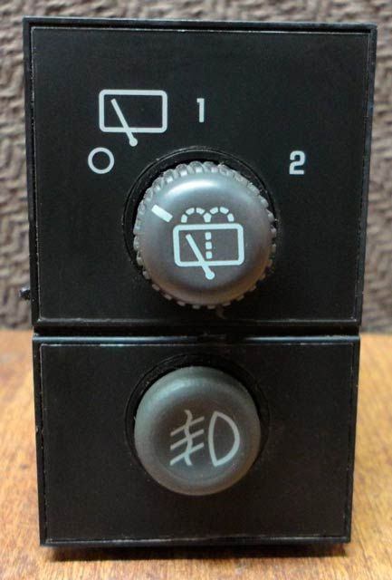

Very interesting info! I'd seen this exact photo before but it never really crossed my mind to catch all of those subtle little differences. Couple more tiny differences - the 12V outlets have 12V on them in mine. The letter/icon spacing on the three lower 4WD buttons is spread way apart on the ones in the picture above. You might also notice a mysterious button on mine under the rear wiper switch....

My truck has that button because i have the front stock fog lights on the grill guard

You can get one from an SUV and it plugs right in a fits perfect in the H2's. Does not actually do anything without some extra work though. I think 5" daytime running lights are idiotic so I converted them to driving/fog lights. Adding in a latching relay to have the button control them. You can also swap the BCM if you wanted to go that route as well. Our BCM will respond the button press when viewed with a Tech 2 but the outputs are not enabled in the software and I cannot find anyway to enable the output other than swapping the BCM with one from an SUV with the same RPO codes but also fog lights. I'm still undecided on which way I'm going to go about it....
