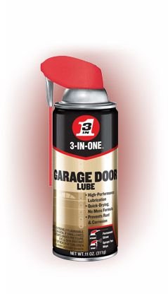

I use the same 3in1 stuff I use on my garage door track, wheels, hinges, screw drive and spindles. It hasn't let me down yet and I like the "never lose" straw. Easy to direct the spray exactly where you want it!
