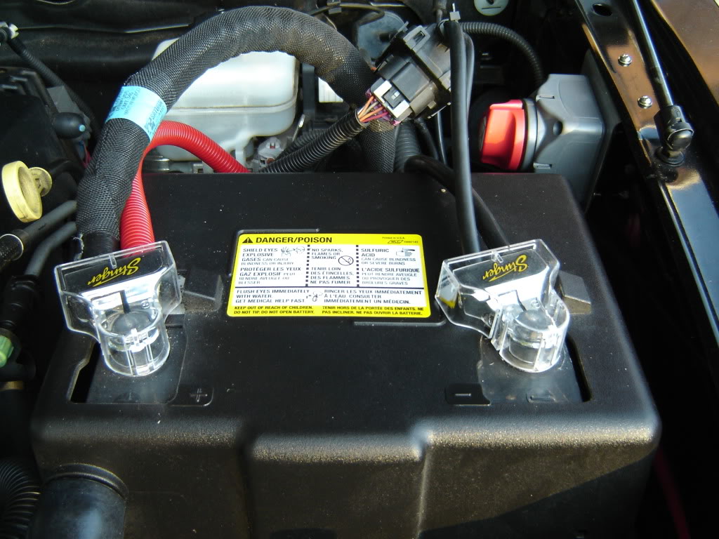

Do you still have the absolute crap azzed OEM battery terminal connectors? If so, hack those off now, do not wait, replace them with a quality aftermarket set. Search this out for the long story, the short version is, they suck and cause problems, the PCM and BCM are very sensitive to even minute changes in voltage .... Gremlins love that.
