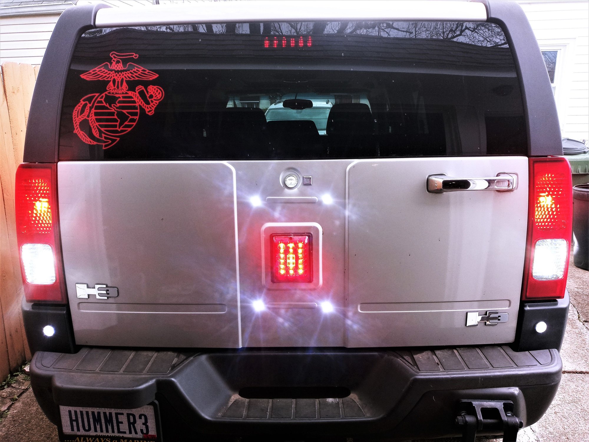

Yeah...........I made up some. I used a thin SS laser cut plate that attaches to the inside of the OEM housing replacing the burnt out OEM guts with a High Power 6-5050-SMD LED Strip Light. Which you can later replace with your own LED strip lights if they ever burn out. Still using mine and going strong. I still have some.

Just checked taillights. Noticed 2 issues, license plate bulb burned(led time) and there's an amber tint coming from the DS taillight. The cheap high mount mod, is still working 5yrs later.
Tail light (reverse) bulb replaced at no cost to me to match 3157 102 smd 6000k all 4. I also purchased and installed 1 of the 20X Super White T10 194 168 W5W 2825 LED License Plate Interior Light Bulb 6000K for the burnt license plate bulb.
