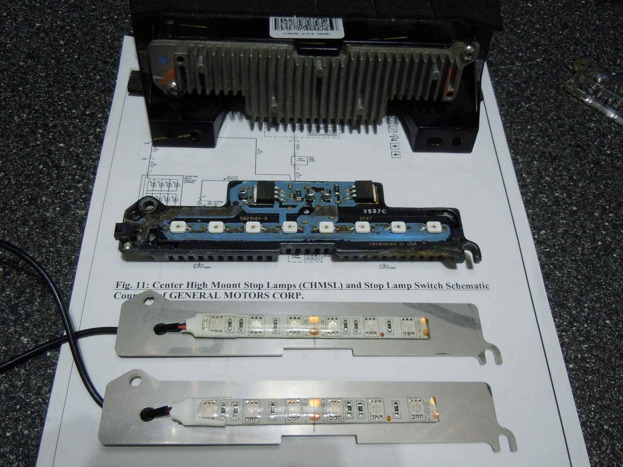

I found an old post in The Google on using LED strips to repair it. (It may have been Doc's post, I dunno) anyway for $20 at Walmart bought a set of strips, cleaned up the old LEDs and installed the strips, rewired and been working fantastic for about 9 months now.

Doc didn't go into detail but I got the impression that it was new 'guts' to go into the existing housing that would replicate O.E.M.......BUELLER?...BUELLER?

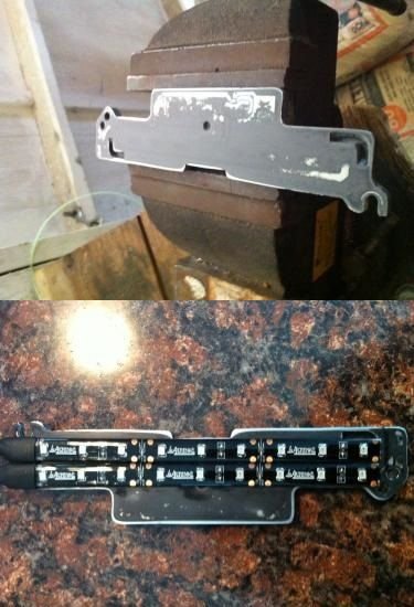

Old Apr 26, 2022 | 11:46 AM
Yeah........... I made up some. I used a thin SS laser cut plate that attaches to the inside of the OEM housing replacing the burnt out OEM guts with a High Power 6-5050-SMD LED Strip Light. Which you can later replace with your own LED strip lights if they ever burn out. Still using mine and going strong. I still have some.

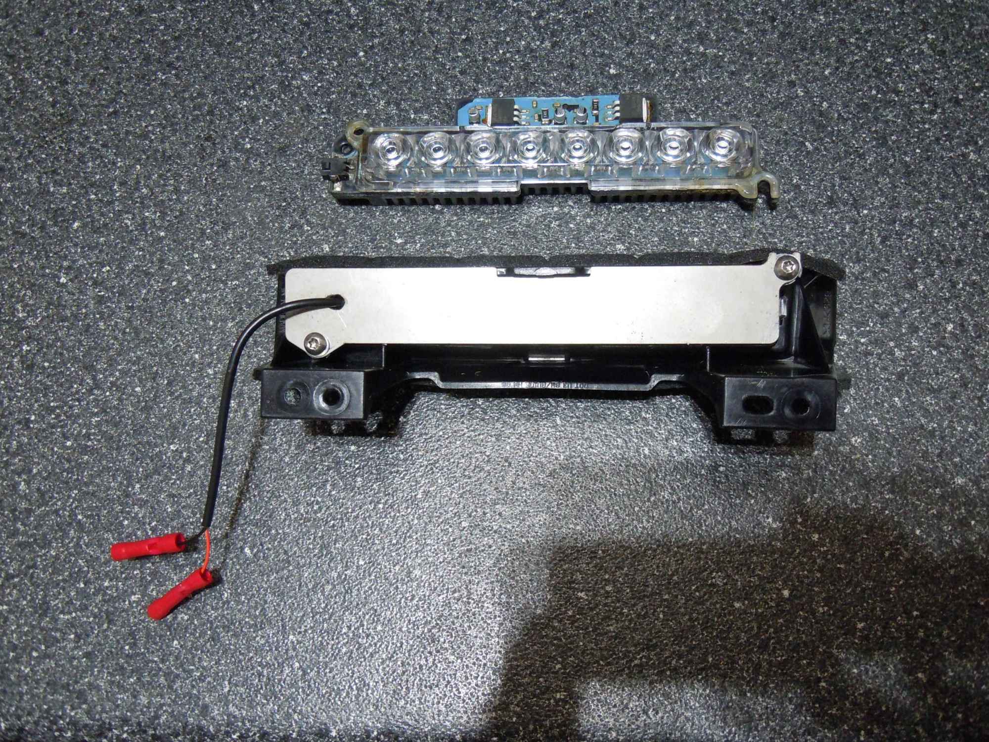

There are dozens of LED lights that can be retrofitted inside the housing of the H3 light. Here are a couple; Pick your poison:
https://smile.amazon.com/dp/B098DLBT...lig_dp_it&th=1
https://smile.amazon.com/dp/B07V9FV1...NsaWNrPXRydWU=
I used the second ones, 2 of them end-to-end, about 4 years ago; they're still going strong.
