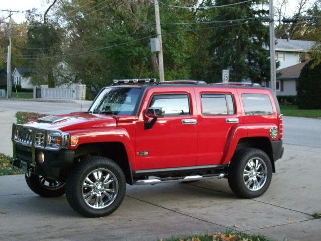

i have a 06 and all u need to do is take the bolt out that holds the recovery loop on and then there are 2 bolts that connect to the h3 and all u have to do is loosen enough till there is room to set the guard in place and then re tighten those bolts and then put the recovery loop back and slide the bolt through and tighten and your done. its so easy that my 2 year old daughter can do it if she had the strength
