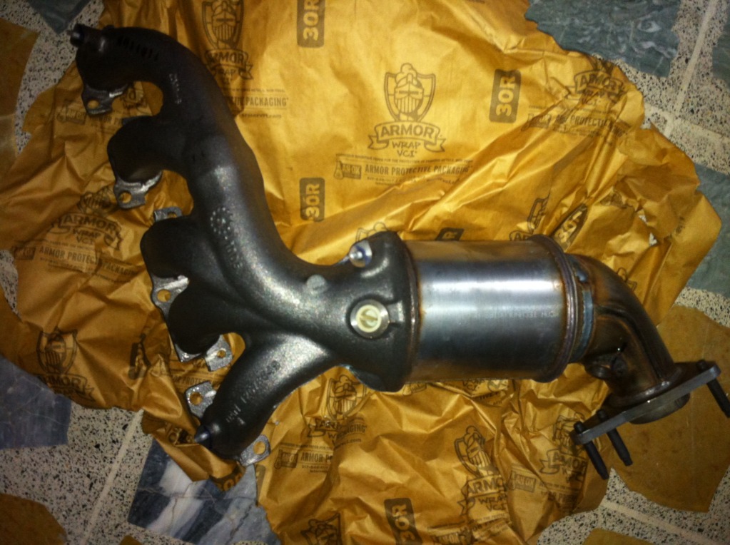

Old Sep 29, 2012 | 05:56 PM
Alex2012's Avatar
Joined: Jun 2012
Posts: 59
From: on earth lol
new exhaust manifold
