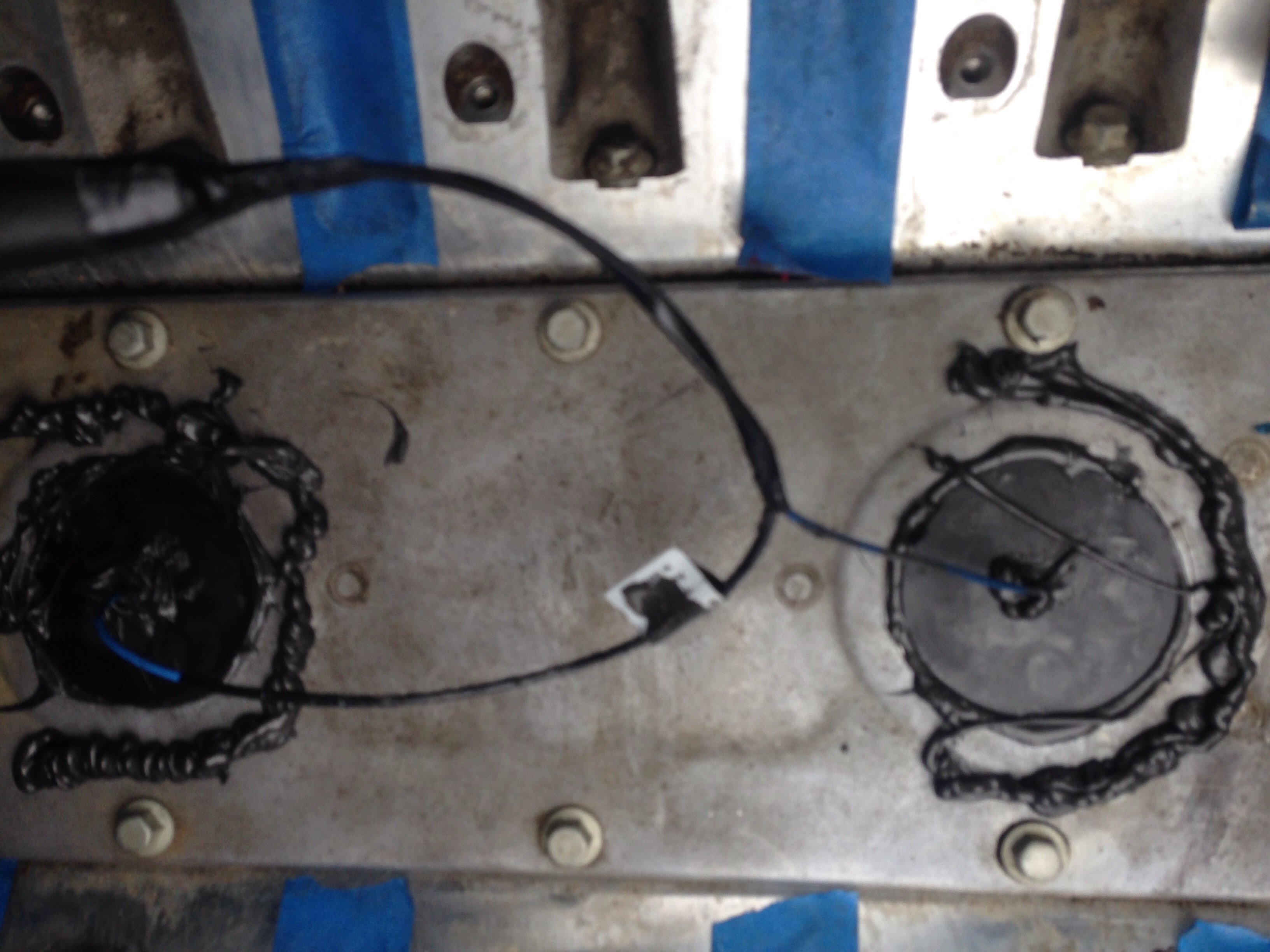

Be very careful spraying around your intake. My mechanic soaked my motor with a hose and the water got into the knock sensors which are located under the intake. I had to replace my knock sensors, harness and intake gaskets.
The seals are known to fail and the foam under the intake allows it to pool and seap in. I knotched the rear foam and left the front one out so water would exit freely.
Also built dams around sensors to divert water around them.
Just be careful with the water.

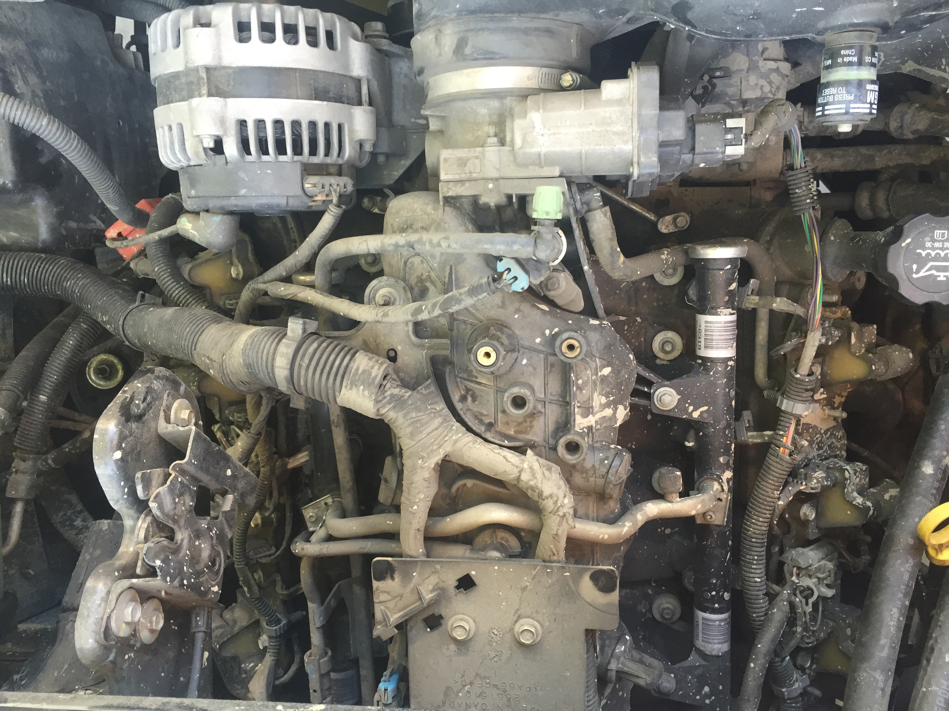

Default Before
Before.

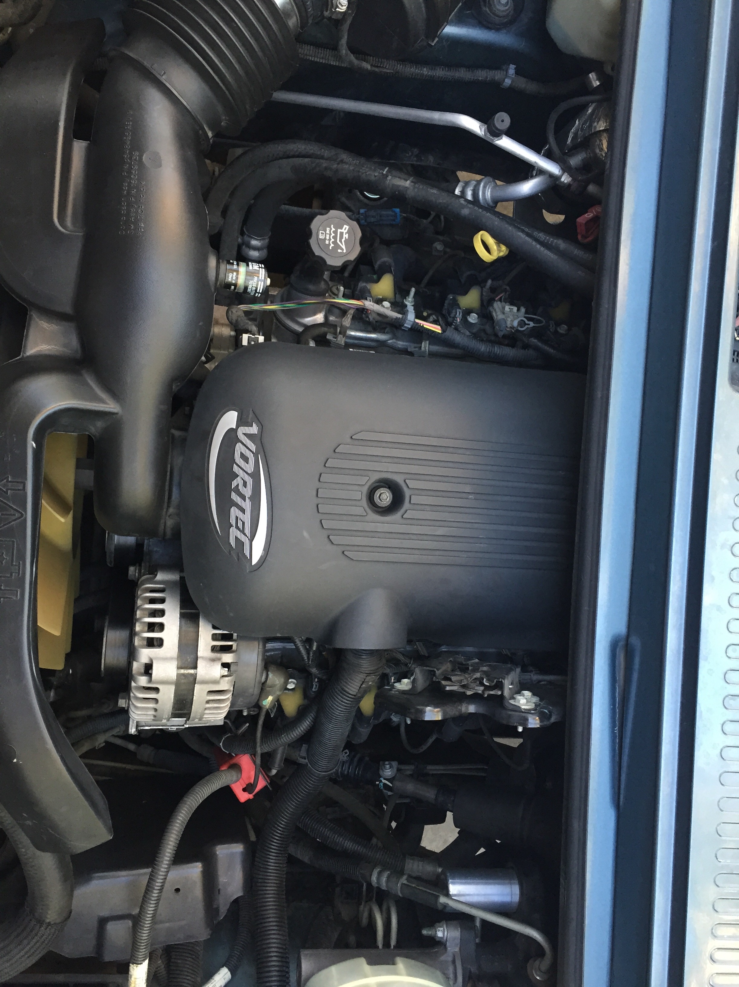

Default Final
I covered the alternator. Took off the intake and covered the trottle body the. Scrubbed everything with a plastic brush rinsed it waited till it dried applyed gunk original for about 10 min scrubbed again around the really bad parts and rinnsed really well. I did not use the shine product maybe next time also let the car run for avout 15 min till everything looked dried

Default Final 2
Sorry about the multiple post i cant figure out how to add multiple pics im using my phone
