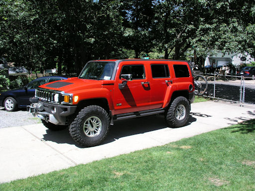

I just went from 285's to the new Goodyear MT-R with kevkar tires in the 315-75/16 size. I raised the truck 1" but had them mounted prior to raising the truck. I didn't have to raise it I just wanted a little extra ground clearance in the front.
Sounds good, now where are the pics?

Sorry but I'm out of town. When I get back (friday) I'll try and post some.

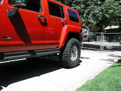

Here are some pics. 315-75/16 Goodyear MTR with Kevlar Tires on stock rime. I have an old 315-75/16 Goodyear Mtr for the spare. The tires are remarkably quiet for the type of tire it is. So far so good. I bought them for my upcomming trip to Sedona AZ, Moab UT, and Breckenridge CO in August.

Very nice Oruna!
