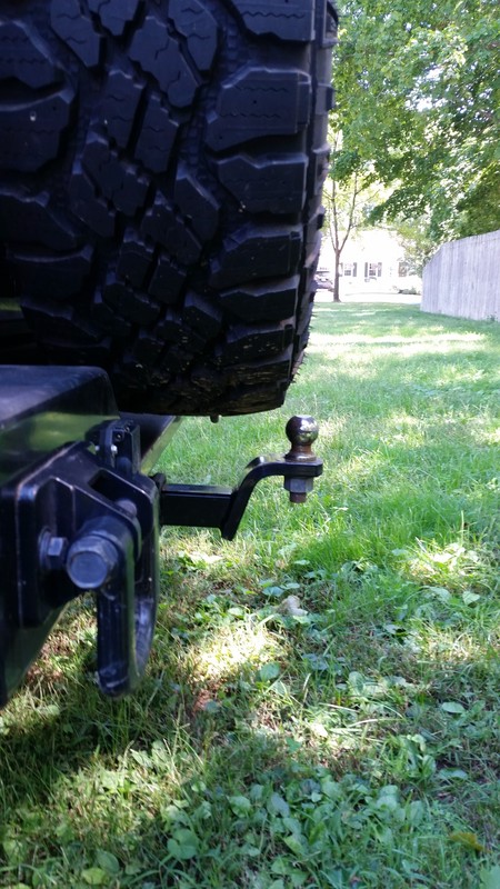

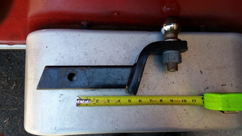

Like I said earlier, I needed a higher hitch to keep my trailer level.
This is a standard 3-1/2" drop hitch mounted upside down.
It easily clears the 315/75/16 Duratrac spare.

I think I see the problem.
You don't have a factory hitch receiver.
You have an aftermarket hitch receiver.
The factory receiver is mounted thru the bumper, sticks out past the bumper and the pin hole is right near the end of the receiver tube, so my hitch sits further out away from the bumper.
The aftermarket hitch receiver, while it sits lower, stops short of the bumper and has the pin hole further back away from the end of the receiver, making your hitch sit closer to the bumper.
Old Sep 18, 2015 | 10:32 AM
mr.spooky's Avatar
Joined: Nov 2011
Posts: 77
Yea, your right, its a aftermarket receiver. I didn't think to mention that, I just thought they were all kinda the same... looks like Ill probably go the "open the door" route just so I wont need to buy another hitch.
