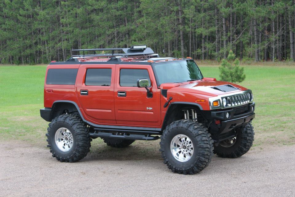

LOL me too but heck with that price. the cheapo ebay one looks cool enough for me. it is so high up that its hard to put anything up there anyway. i think hte only thing i have put up there has been wood bundles so i dont get the wood all over inside.

I love the look of your rig on those tyres. I'd definitely like to get set up. Thing is though I live in the middle of the city centre - equivalent of manhattan, it's bad enough trying to navigate round here in it, with that lift and tyres, i think it would be even harder. Having said that, I'm always keeping my eye out on parts... ! (group bulletproof/gobi buy anyone ? )

the tires rub really bad haha, it needs, imo, a 12" to really utilize the 44" size tire to the full extent during a flex. i can only flex a few inches now before it hits so it isnt real conducive to wheeling.
my next set will be in the 40" range and be a little better for roads. the1.5" lug on those boggers when new were killer. they are still about a 1/2" of lug in front and 3/4" in the rear. it howls like an air plane and (until the tires warm up) rides like a wagon of the old west. haha the bias ply really flat spots with 8k# on them. (who would have thought haha)
nitto makes a nice looking tire for these imo, and they make some nice sizes that we can utilize when lifting. the other main thing to be concerned with, the offset of a wheel if you dont keep the stockers. have to keep it kinda tight, in the states there are usually laws stating that a rubber cant be 2" or more out past the truck edge. be it a flare or something else but 2" is max. some states have laws for 8k# and lower, as wi is from the last time i looked. 9" total lift is also a state law for wi along with light height.
be sure to check the laws when lifting just in case!
