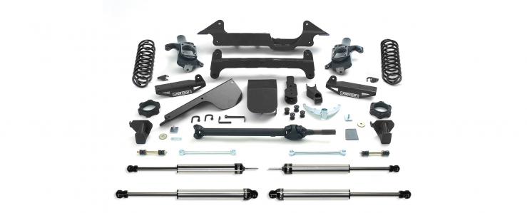

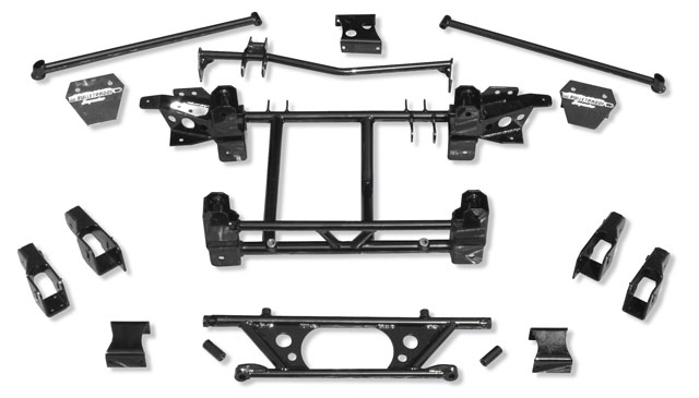

What is the difference between the Bulletproof and the Fabtech? I know on the Bulletproof you won't have to cut an ear off the rear diff... But to me that is not a big deal... I seen a pic of the parts in the kit and it looks to me like the Fabtech has a lot more parts. What one is better from an engineering point of view? Cutting off the ear on the diff is not that big of a deal for me IF it would lead to less wear and tear on the front end. The first one is Bulletproof followed by Fabtech.
