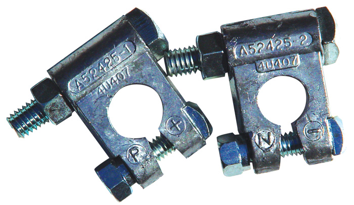

Look for either Stingers, or the military type. Do not use the universal cheapo's
Just remember that POS & NEG posts are slightly different diameters. You need to get one of each connector. They are marked + or -.
You can get Stingers from Amazon or other online places
Autozone has some good ones as well.
Metra Electronics Stock/Gold plated negative battery block terminal BT705 at AutoZone.com
These are the military type, also available online.
