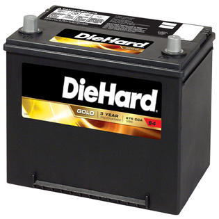

Great deals happening at Sears.com : coupons, discounts, cashback, etc,, on batteries and they are AMERICAN MADE DEKA BATTERIES 3yr free replacement:
Sears.com
I just bought 1 last week to swap out my 2yr old optima, paid $76.04 for the 86 gold diehard and sold the optima on cl for $75.00..

Where did you get it for that price? All I get is $135.00 for that battery.
States it is for Northern weather. Need one for SoCal weather. Temps as high as 110º.
Any suggestions?
