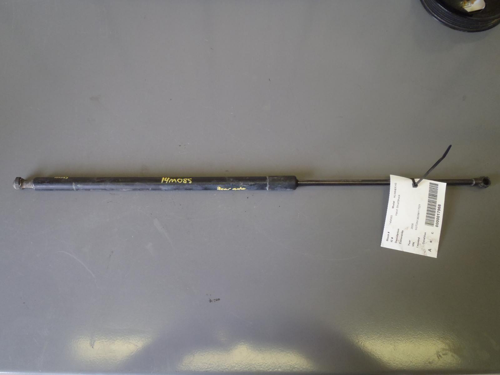

Gas strut replacement for rear swing gate...
I've already got the part (Tuff Support 610714) but can't find a simple set of instructions for removal and installation.

Thanks doc but the model I purchased does not have that type of heads. The hood had them and that was quick to figure out but this one is a ball socket with NO spring clip retainers.

Old Mar 9, 2018 | 07:17 AM
Broken Halo's Avatar
Posts: 1,461
Found this by the picture you posted the link to. Shows how to replace the strut you linked.
Changing a Car Gas Strut
Thanks.

All finished with the miss' h3. I now realize mine stinks...lol! I've ordered a Stabilus / Sachs Lift Support SG230109. Seems like a nice one. Ran about $27.
By the way oem 15255554 , 15864389. Cheapest with s/h was close to $45.
