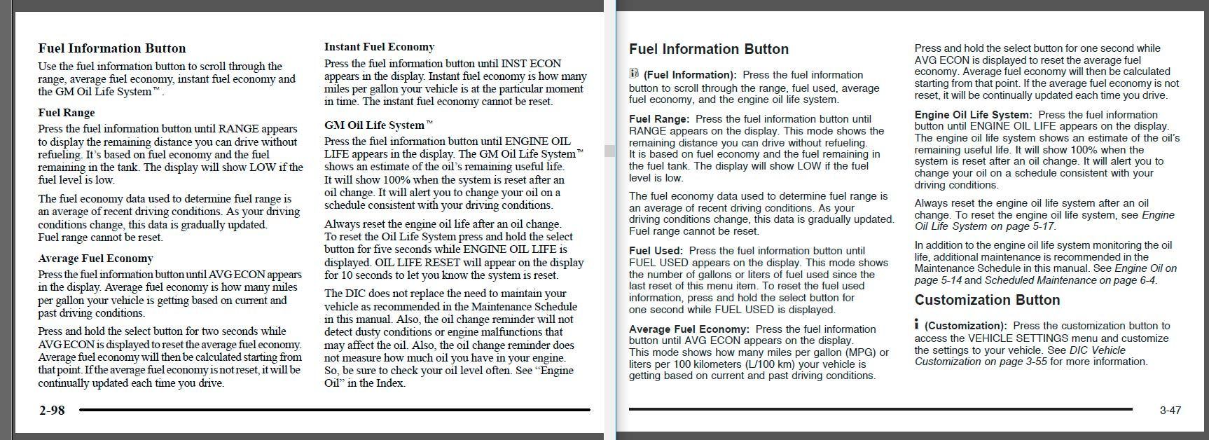

Well that's one I'd have never guessed. Apparently someone thought that the instant function was not useful at GM and decided to remove that feature or they traded the instant feature for a fuel used feature.... It is fun when coasting downhill, with a tailwind, and see my H2 proclaim that I'm getting 50 miles per gallon. lol
2003 on the left, 2006 on the right....

Mixman . I thinkin general Gm did good in removing the feature . There will be more hate and more people loosing hair while looking at the display marking 4mpg while going up hill towing a boat .
And not talking about thousand more thread in this forum on "please help how can I save gas "
Lol

Its a calculated value based on mass air flow and the idea that the PCM will keep the fuel flow at 14.7 to 1. I don't think any of the H2's had a fuel flow sensor.
With some tweaking you can get it very close based on mileage from fill ups.
Neal
