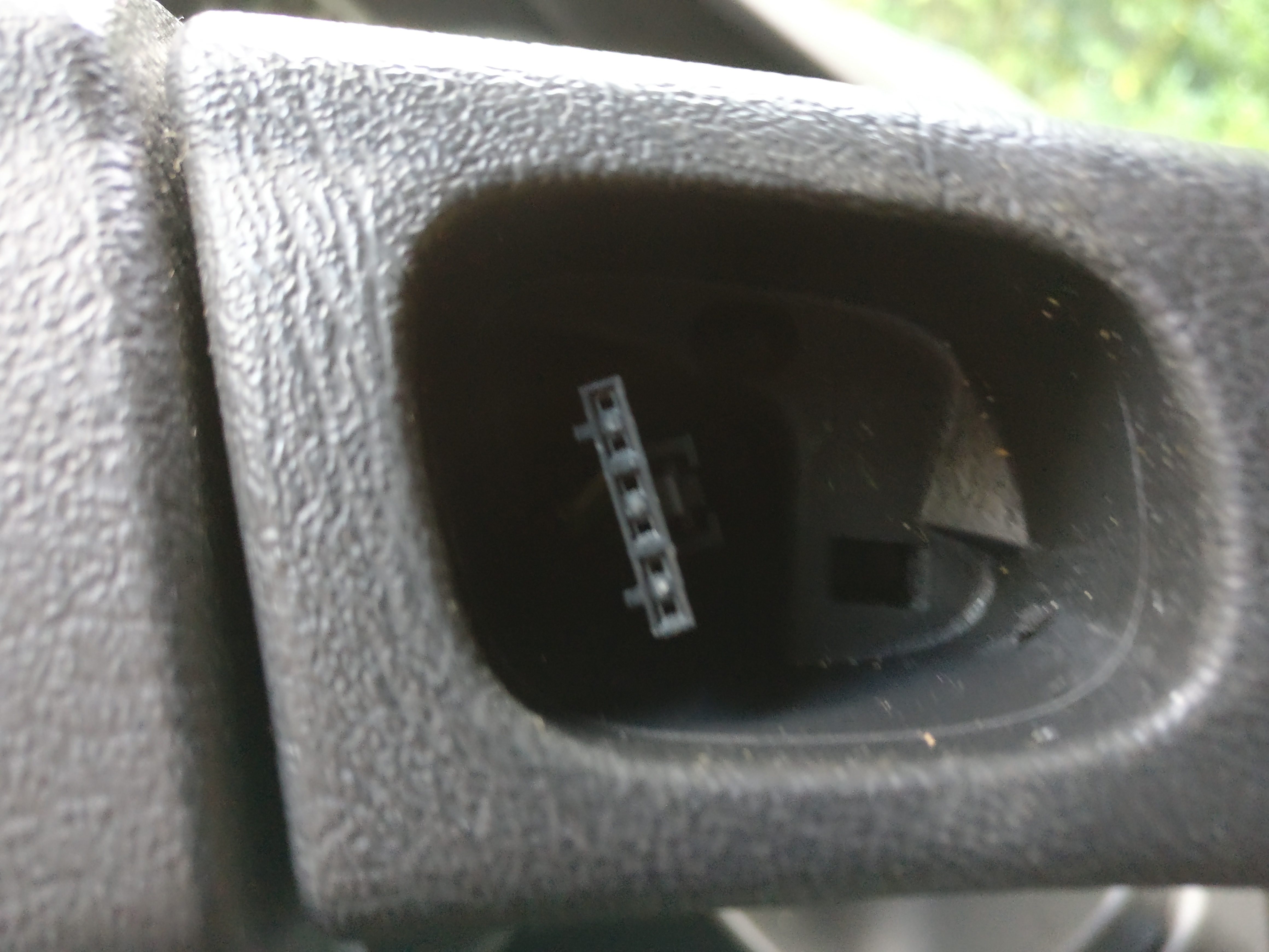

Quick question... when I pulled out the switch, the wiring connection seemed very short, so much so that I could barely get the switch out and was afraid the wiring would unclip from the switch when I was taking it out, which would be very hard to get back on since it's so short. When I install the new one, is there a trick to get to the wiring connector a little easier? If I pull a little harder should the wiring give itself a little more slack or is that all there is? It isn't long enough to come out of the steering wheel hole that I can tell, which will make installing the new one pretty difficult.

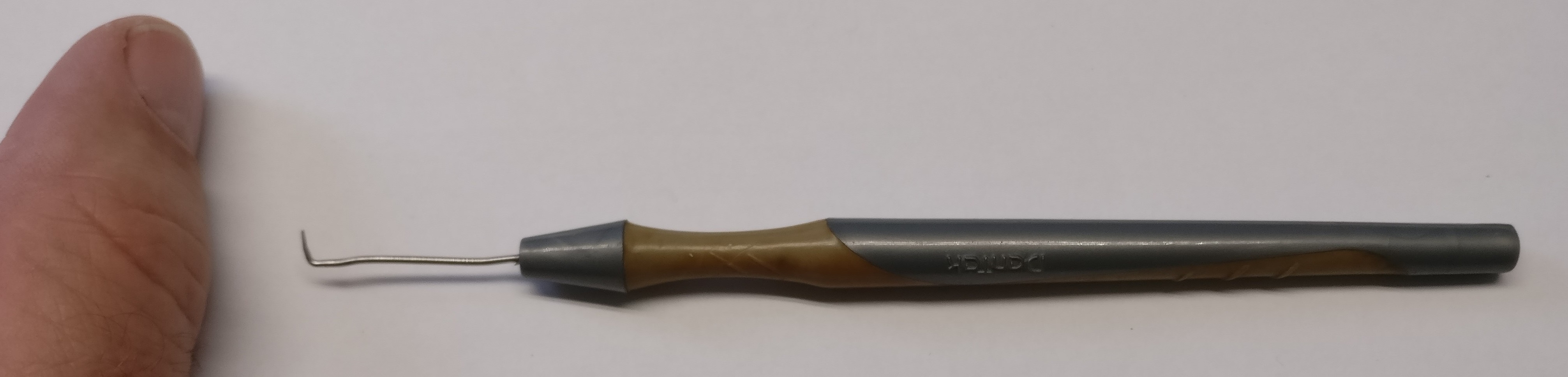

Replaced my top two steering switches yesterday and as you say the cable is really short.
The tool I used was a cheap dental-pick re-bent to form a small hook tool (see jpg) Even a stiff piece of solid-wire could be used.
I used the tool to pull-out the switch (really easy) and used it again to release the latch on the connector alowing the switch to be pulled-out without starining the wires.
To fit the replacement switch, slide the tool down the LHS of the connector and between the the wires in the middle (for balance). Align the connector with the switch and holding the tool firmly and push the switch onto the connector then just slide-out the tool. Check the connector has "latched-in" and then test that it works. Finally push the switch back in.

Yep, thats how to change it. And no, there is no extra slack on the wires unless you remove the airbag.
