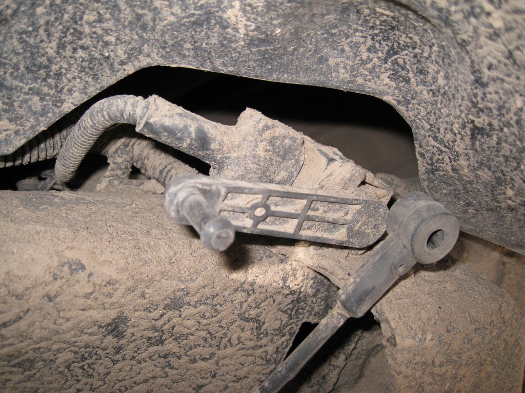

From: Cloudcroft NM
Mine did this till I disconnected the two ride height sensors in the rear wheel wells. I get the 'service air suspension' message, but the ticking stopped.Name:  IMG_4680_zpswtnoqxxs.jpg
That worked. Thanks
