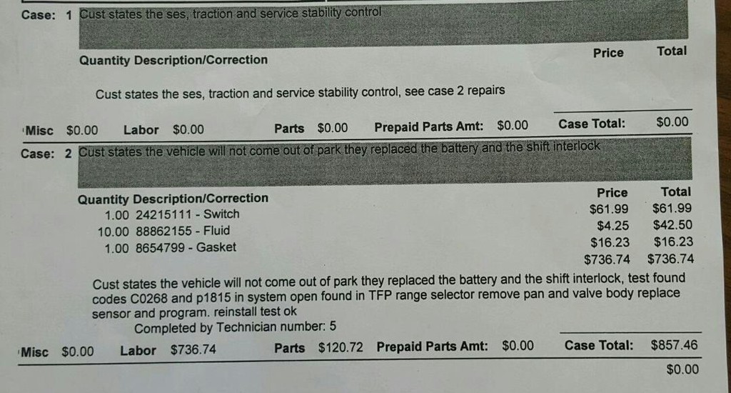

So apparently the salesperson completely misunderstood what was going on. The h3 actually had a problem where it got stuck in Park and wouldnt shift out of it. So they sent it to a GM dealership and paid approx $900 (showed me the invoice) to fix it. It mentioned an Engine code that came up but i cant remember what it was. Shes going to email a copy of the service invoice so i can look at it again.
Should that be something to worry about? Being a recurring problem?

I suppose i should have mentioned that i would provide the codes when i got the invoice.
well i got the invoice. Codes were C0268 and P1815. From an internet search it looks like p1815 is a bad switch which im guessing prevented it from leaving Park. That was fixed.
C0268 is "Class 2 Data Error Reported" according to an old post on another Hummer forum. Could that one be paired with P1815, and not a separate issue?
This is a vehicle i am looking at purchasing. The dealership has an 06 w/ 55K miles and this 08 (w/ adv package) w/ 66k miles. prices are pretty close together.
Is it possible for these codes to pop up again even though the switch was replaced? A reason to steer away from the 08 and look at the 06 instead? Just trying to be an educated buyer so i dont get into something that may have recurring issues.
i have attached a picture of the invoice for reference.

Get the 08 Adventure. Bigger motor, 4:1 xfer case, locker. No brainer. I wouldn't worry about the condition if the carfax doesn't show repeat problems there.
