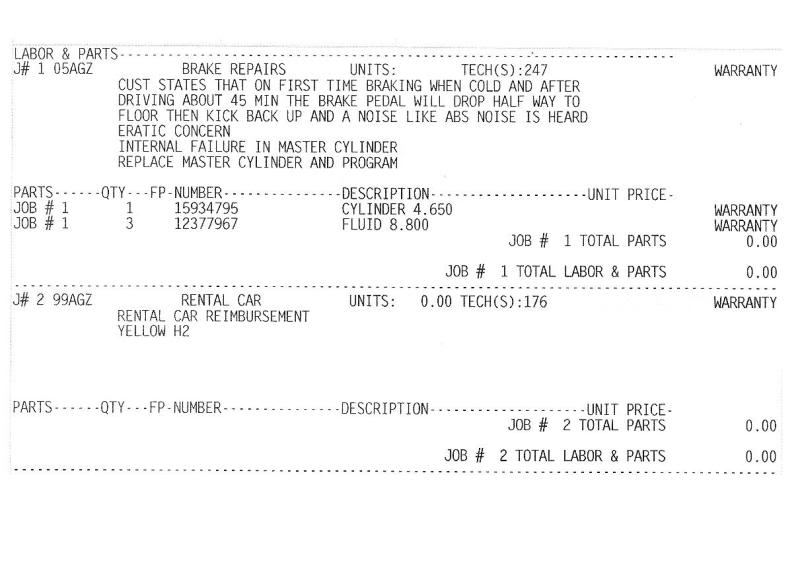

This is right off of my paperwork....i suggest if anyone is having this problem get your truck into the dealership and get it fixed

Well I am one of them. I wonder who the other one is? If there is 3 of them in the northwest detroit area, how many more are there. I smell a recall. The yellow H2 was out when mine was in last last week, so they gave me a rental from enterprise.

well my brakes work fine now..ya i smell recall too....that yellow h2 was a sheeetbox im sure there are alot of people with this problem...since the setup of our trucks are off the colorado chassis i wonder how many there are of those too....
