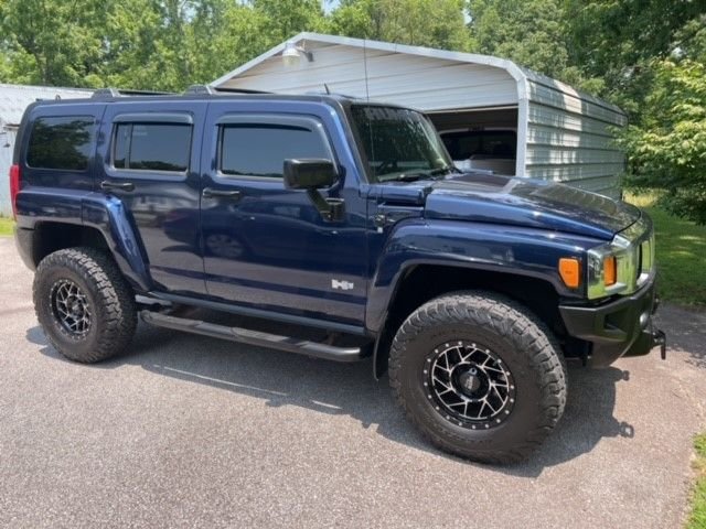

Hi Everyone,
Purchased a 2007 H3 in June and have absolutely loved it. It is in great shape and spent 14 years of its life garaged in Arizona. 145,000 miles with a rebuilt transmission at 132,000. I have read that that was an issue and this one went out around the miles that everyone else's did. The only complaint I have is that the BCM is acting up. Key fob doesn't work, cruise only works sporadically, and TPS starts blinking occasionally. But after perusing some of the threads, I see that the sunroof drain line may be the culprit for this. Gonna check that out and see if it needs cleaning. Happy Hummering!!

Welcome to HF.
You need to do the sunroof drain fix regardless and that won't reverse potential electrical damage caused by any water intrusion, but it will stop additional or future damage, like after you get a new BCM. Plan on reading up on inspecting the BCM and its harness/connections for corrosion and compromise. Thanks for the pic.
