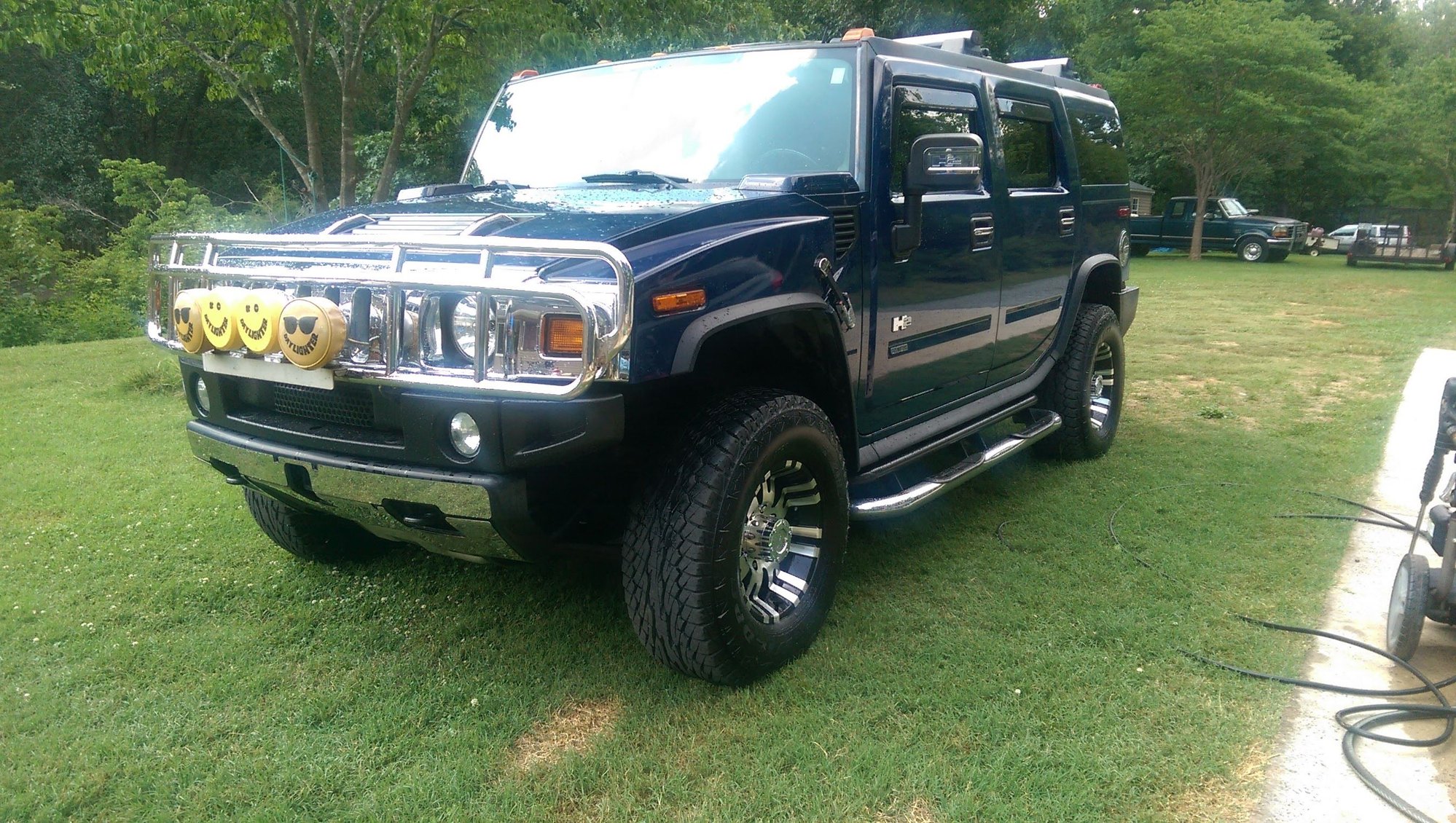

Thanks for having me ...love my 2007 H2. I have had it 6 years now I think....
I had the worst problem..it was like a cancer spreading ..things just stopped working ..i would randomly get service air suspension then all the ABS, Brake light errors and really everything from the power windows, everything on the dash practically, to not being able to switch the 4 wheel drive EVERYTHING ..truck ran great .but wow the errors...even my scanner nor the shops big scanner could read anything but the serial number ....
They didn't want to fix it and talked about how all my modules were gone etc...
So I just let it sit ....
When I went to move after a couple months I had to jump it off the battery had zero charge ...
I noticed that the Abs and brake light werent on so grabbed my scanner...and it read a old communication error to ABSmodule
So I jiggled every connection i could fined from the fuse box out down to the wheel sensor connections
Wow ...everything appeared fixed..took her for a spin and the errors flashed a couple times and the service air suspension and 4 wheel drive lights came on sporadically...
It was way out of registration... here in NC you pay your taxes there ..so figured I better just get it done ......
During the inspection they jacked the truck up by the frame. Letting all 4 wheels dangle so they could check bearing play I guess...
Anyway the suspension was fully extended .. went to leave after the inspection ..and have not had a single error in several hundred miles..towing 4 wheeling...etc ...
So something I thought would be 1000s of bucks and almost ready to junk it...was fixed by just jacking it up by the frame during an inspection
I added a pic of my tag ...I had never considered a vanity plate until this ..I am usually towing a boat or seadoo so thought it appropriate.
