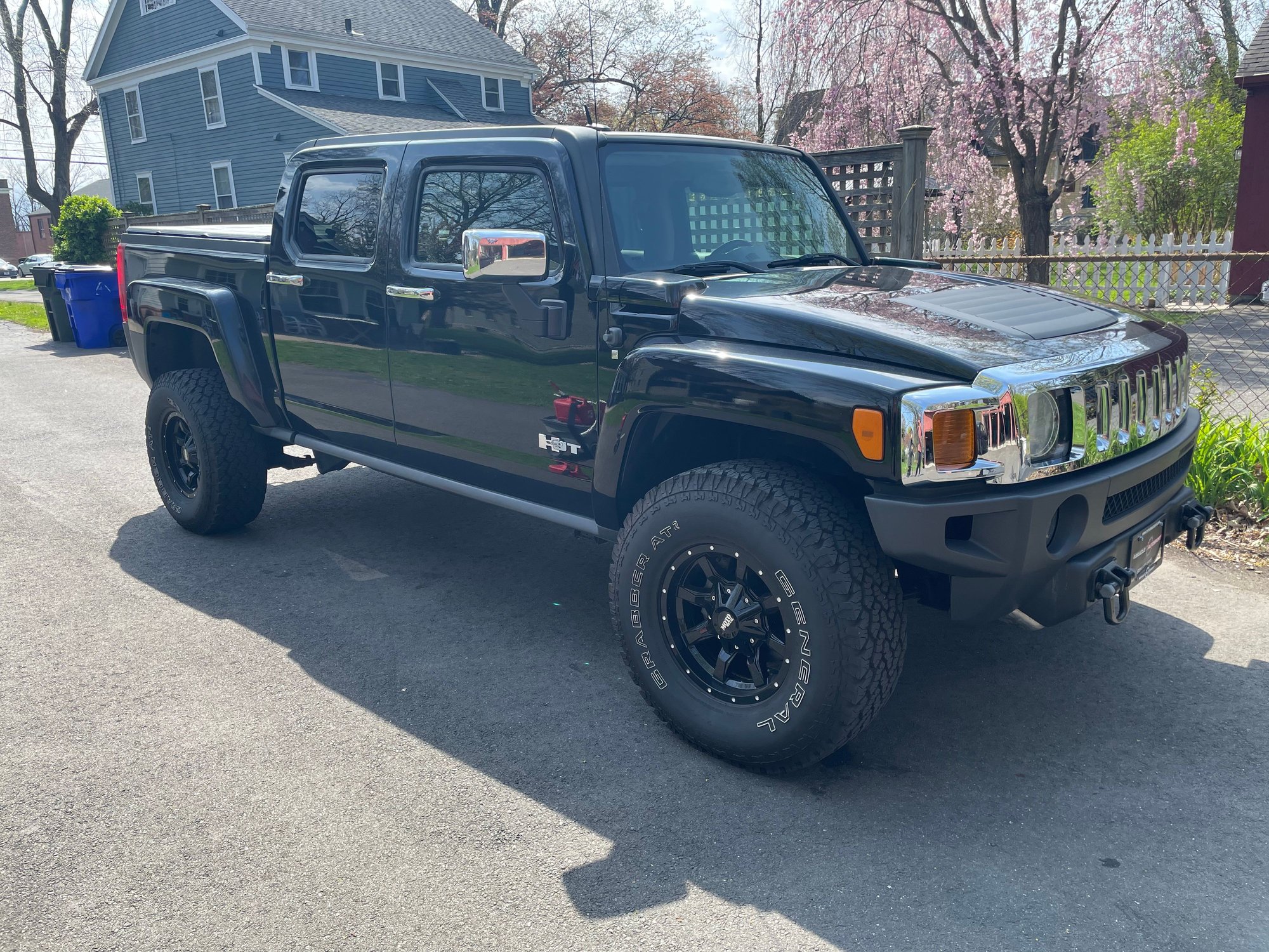

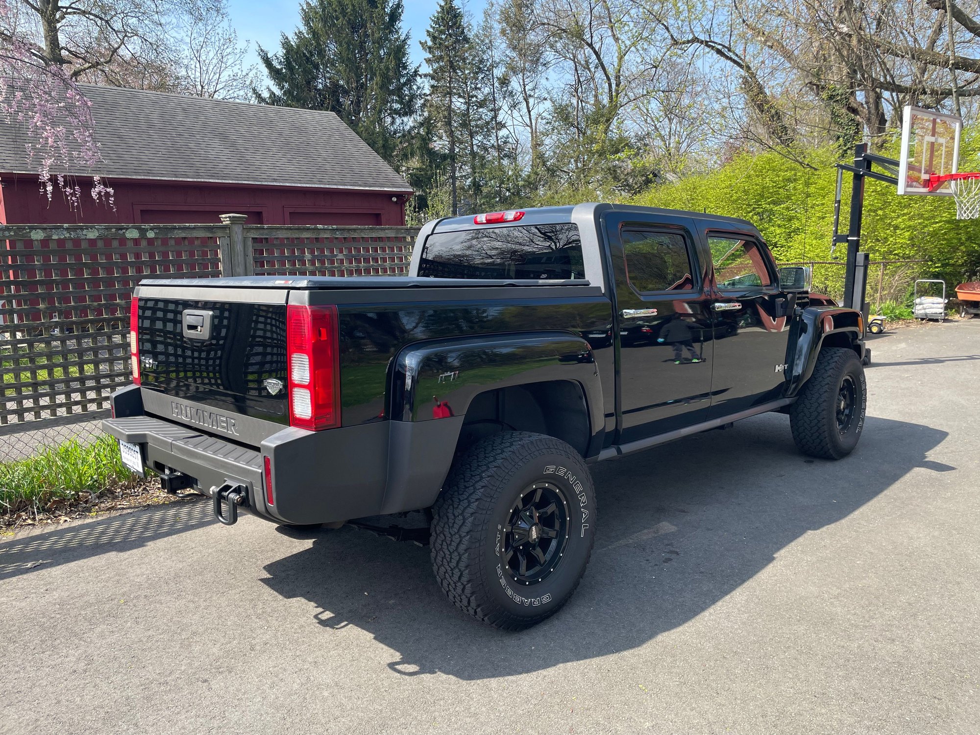

Thanks folks. Here’s my new to me 2009 alpha.

A 35" tire regardless of the wheel size will "fit". Larger 315s (Toyo) will take a bit of coaxing and maybe some finesse but it will fit.
Welcome to HF, nice T!
