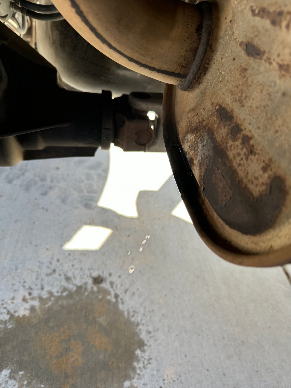

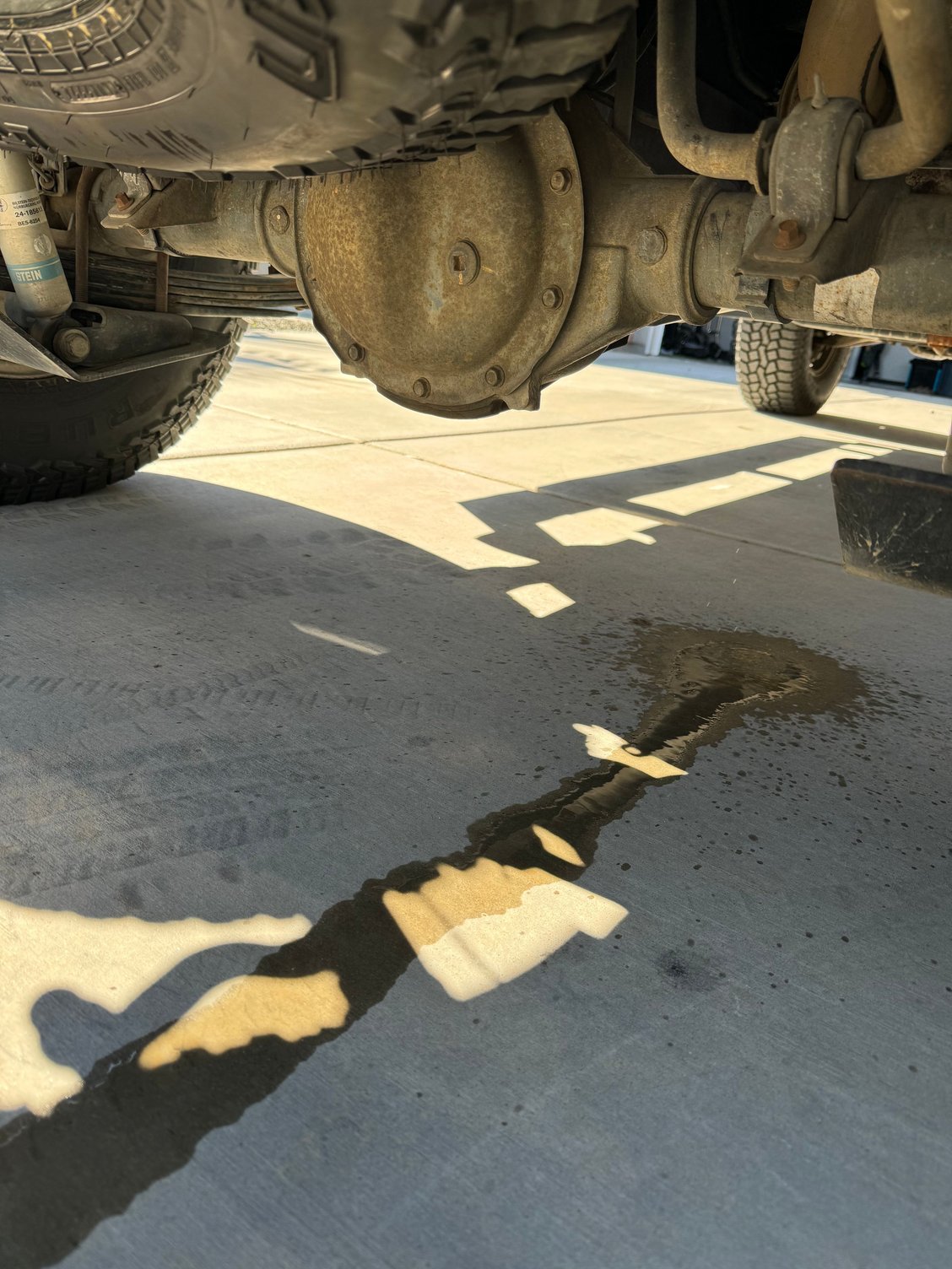

Hello all, thanks for all the help thus far. I recently acquired my dream H3T alpha and I’m trying to tighten stuff up on it. It appears there is a leak at the muffler where condensation drips.
1. How critical is this?
2. Any recommended simple fix?
3. If I need to replace it, what’s the suggested upgrade that isn’t obnoxiously loud but sounds good.
Thanks.
Old Nov 5, 2024 | 02:24 PM
Many Exhaust systems have drain holes on purpose. Yours looks rusty. Critical? Not at all.

All OEM mufflers that I have ever seen have an exhaust condensation weep hole. It allows the "water" accumulated in the muffler to drain and not sit inside the muffler rotting it form the inside.
"Believe it or not, almost every muffler has a weep hole. And the purpose of the weep hole is to allow water -- a byproduct of the engine's combustion -- to escape. That way it won't sit there and rot the muffler from the inside."
