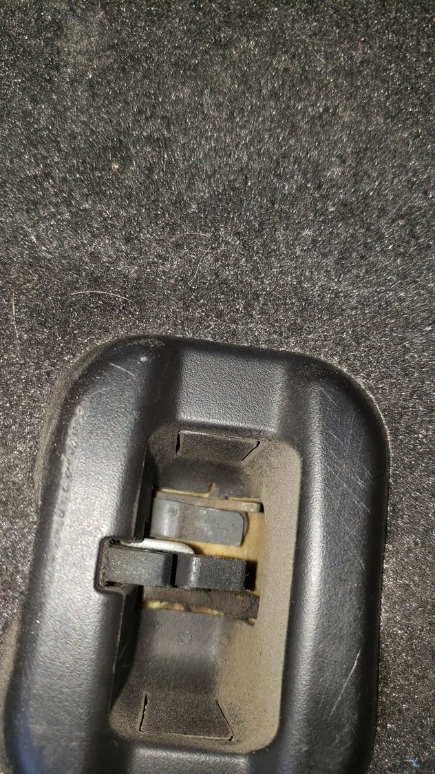

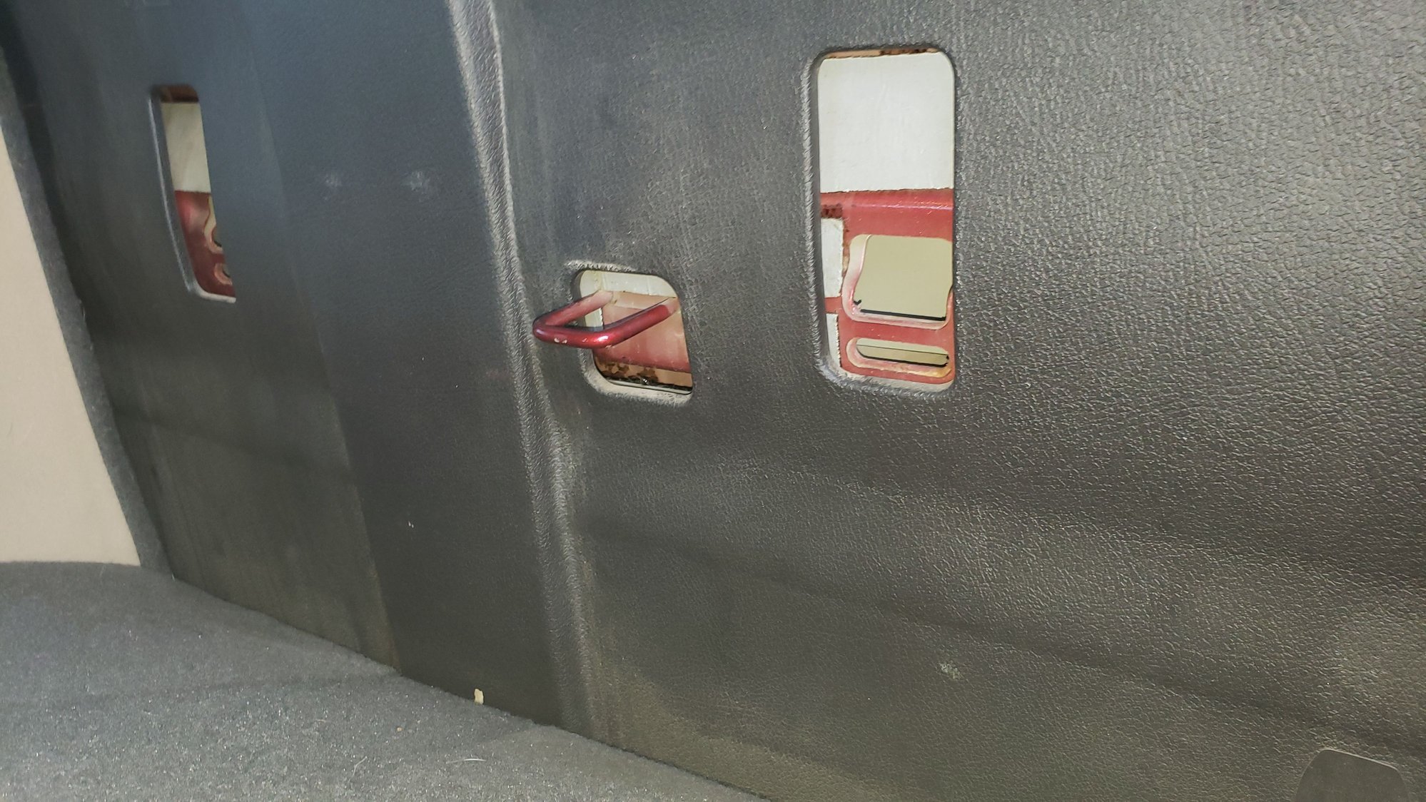

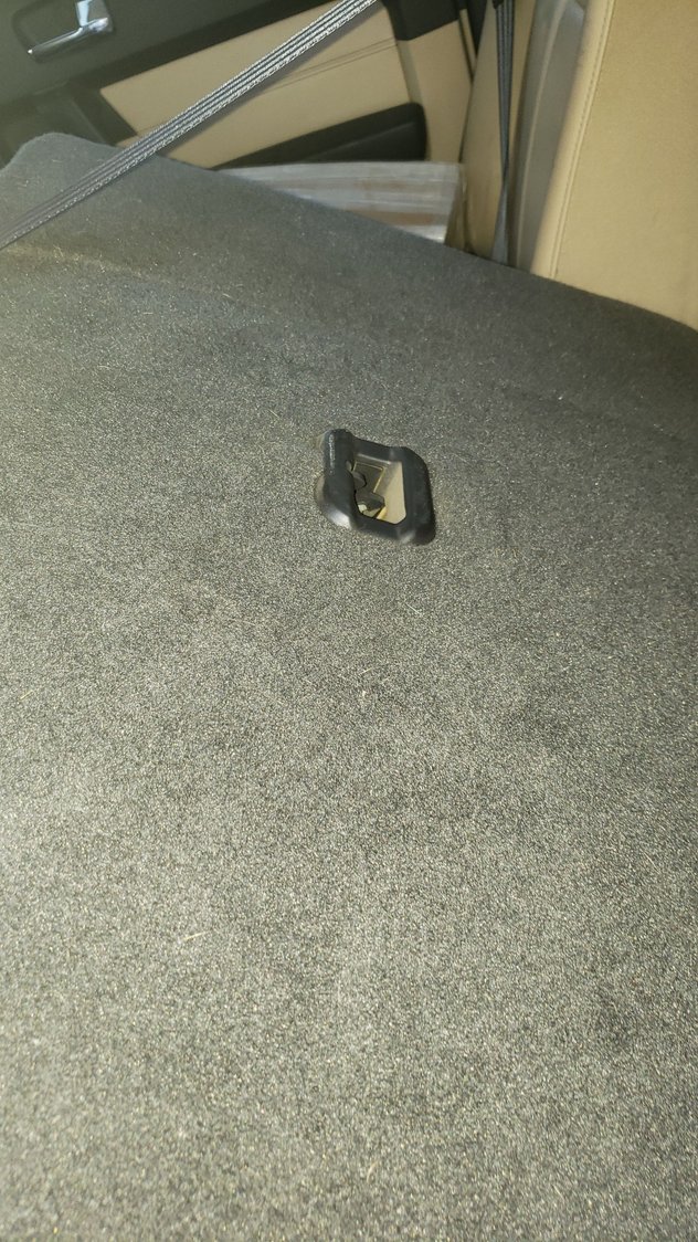

it Anyone is having the back seat reupholstered please shoot me some pics of that mechanism that shows from the pull loop to where it connects to the latch.
Old Jul 30, 2019 | 06:18 AM
Sorry, I took pix but didnt post them. Located in the center of the seat left to right / up and down.

​​Had to get a small bore camera, wiggled it into the back of the seat just to the left of the headrest. Once I found the release lever, I got me a coat hanger, bent a small J hook on the end. Took several tries but I got it.
The cable was fine. What had happened was (I think) the PO pulled too hard to many times and the on the cable.
Folded down the seat back, remove the headrest and the upholstery on the back. I found that the cable sleeve has a bracket it's anchored to. The bracket had bent from the pulling force and the sleeve slipped out.
​​​​​​Straighted the bracket, locked the sleeve in place, tested it out a few times, put everything back together.
