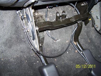

The cable for my passenger side is still attached. But it's not moving the circular spring loaded lever. I detached the cable and tried to pull it with a pair of pliers and it wouldn't bulge. I'm wondering if it might be jammed? I didn't see a lever to use a flat head on. Do you have a photo?
Old May 11, 2011 | 11:04 AM
HummerGeek's Avatar
Joined: May 2011
Posts: 3
What year is your Hummer? You said circular lever but mine has a lever like attachment that the cable attaches to at the top. I can fit a Larg screw driver behind it. You might need to shoot it again with WD40 if you have not done so already. I suggest pulling the seat back forward and backward to try and loosen it up. I herd a loud noise when it broke free for me indicating it coiuld have been jammed. I don't have pictures yet but will post it when I get back to working on it. Do you have any suggestions for replacing the third row jump seat with a bench seat? I only have found one aftermarket company and would like to install a similar seat to what the newer Hummer H2's have. Have you seen any after market seats that I may have not seen?

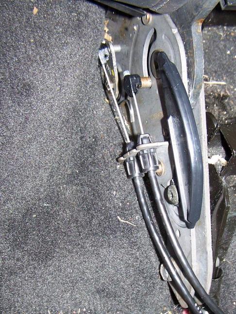

I have attached pictures of the cable assembly under my seat. The upper cable goes under the back of the upright portion of the seat. I'm not sure of it's purpose.The lower cable is what is stuck.

My Hummer is a 2005. And I tried the WD40 and a large screw driver but that lever won't buldge.
