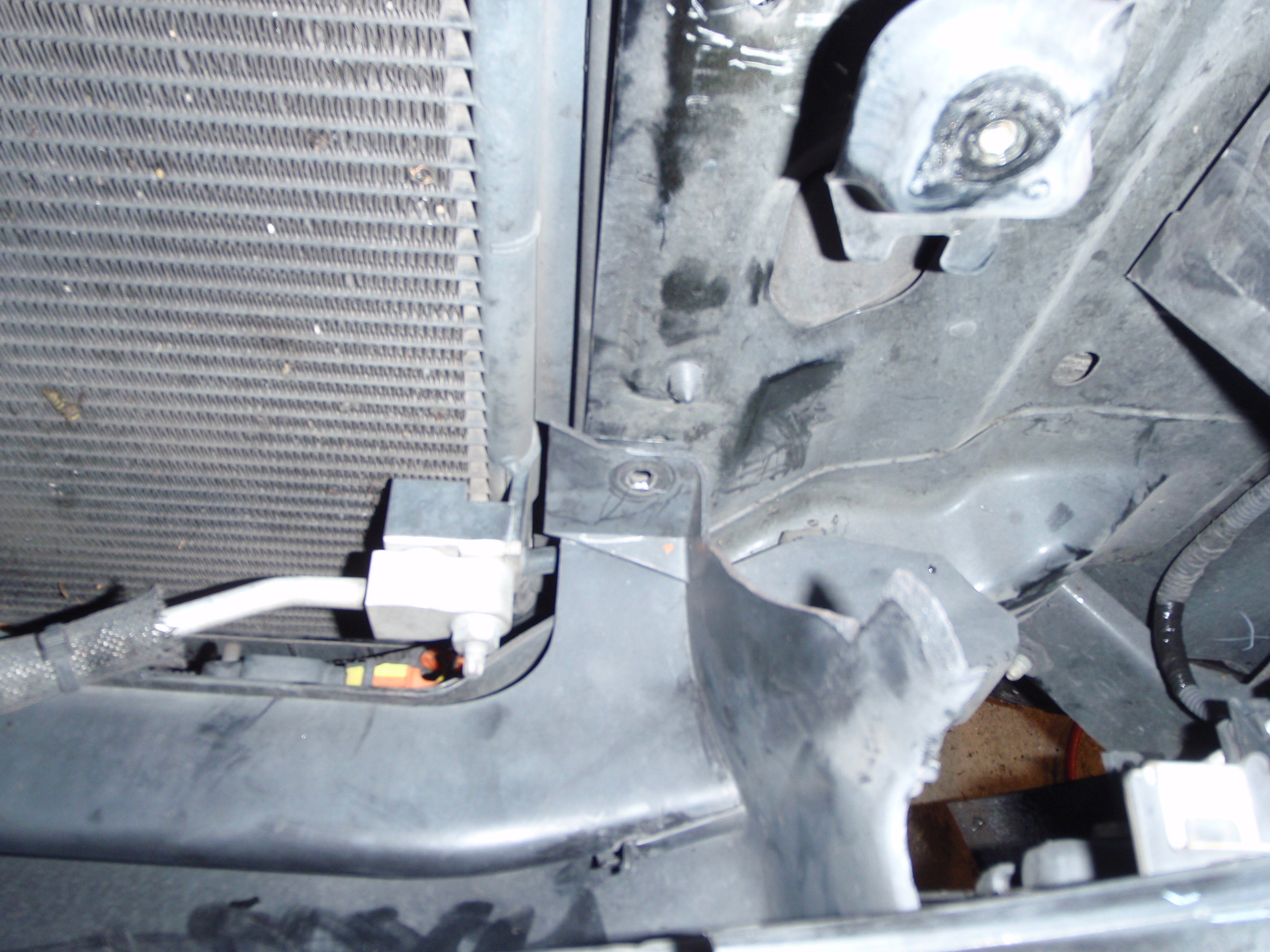

remove air duct
of course you have to take the entire bumper off to remove the air duct

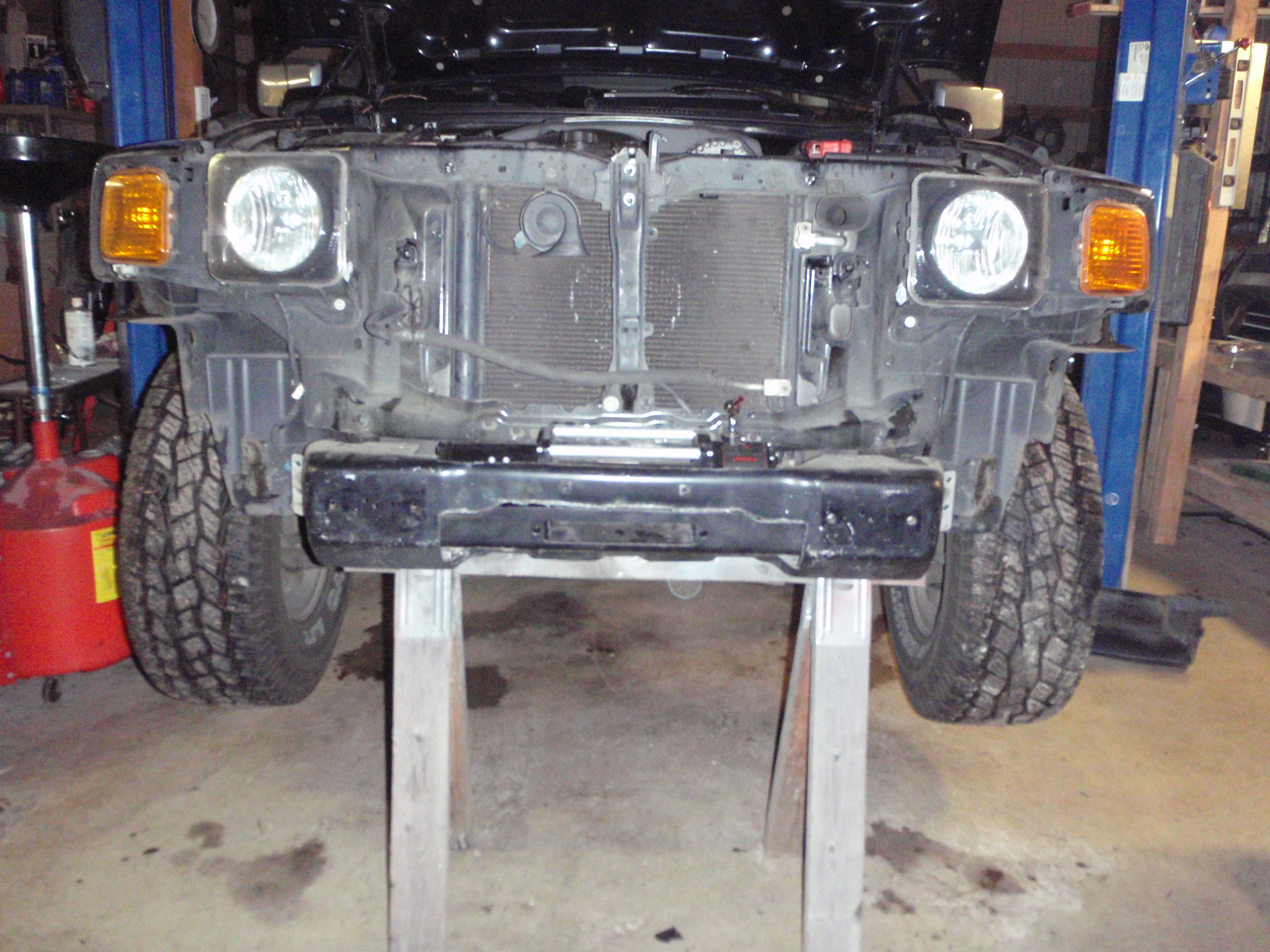

this looks promising
note, there's always a note that H3 Alphas need to use the more pedestrian other H3 brush guard.... now I know why
even with the cut, it's still too far forward

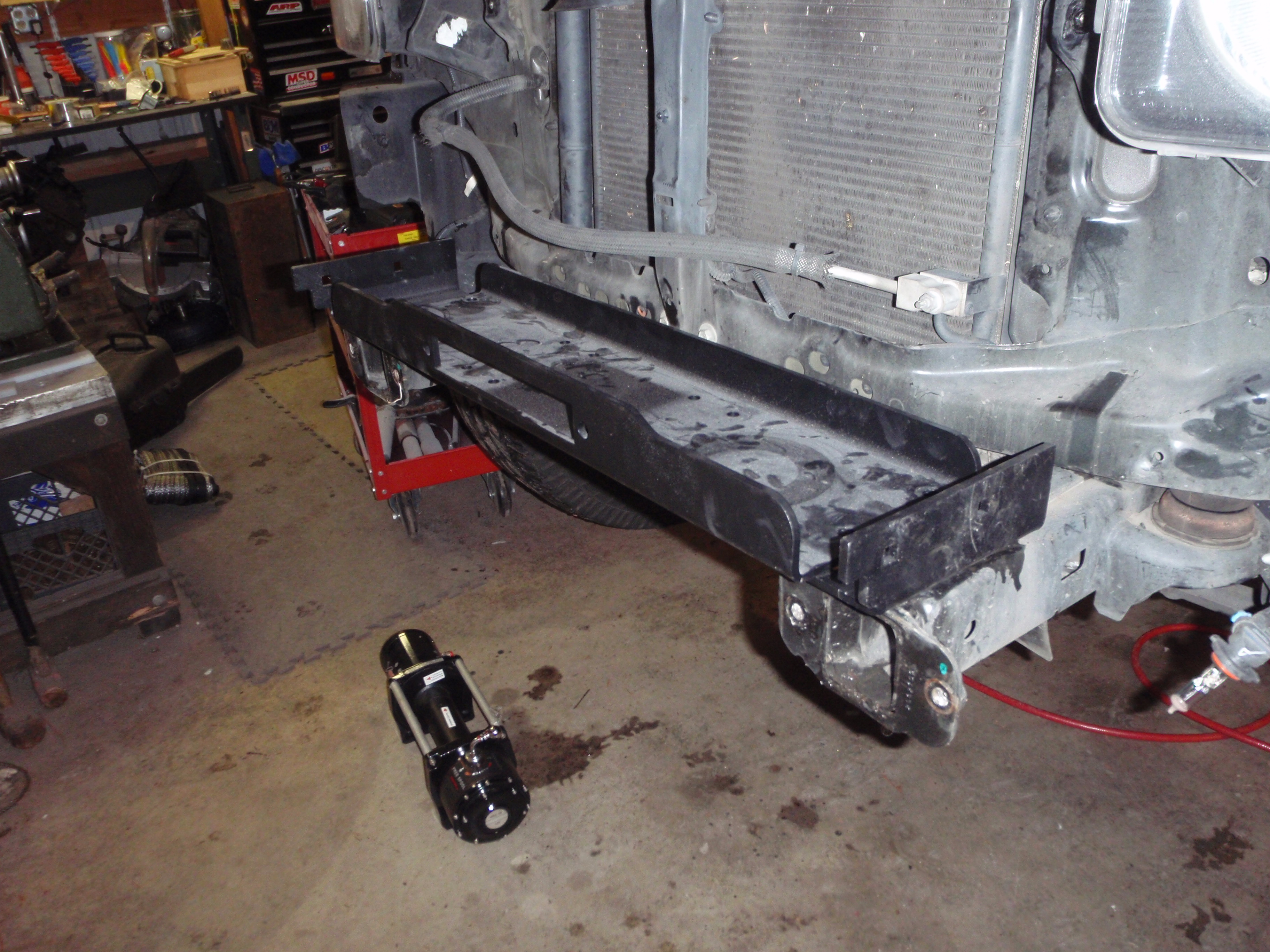

cut the lower part of the tabs that hold the tow hooks
benefit of doing it there is that's a great point of reference for the front
where I finished tonight
Tomorrow I'll weld the brackets to the plate, then drill holes in the frame to mount the wench.. er winch.... the ****** is in the back, two of them :grin:

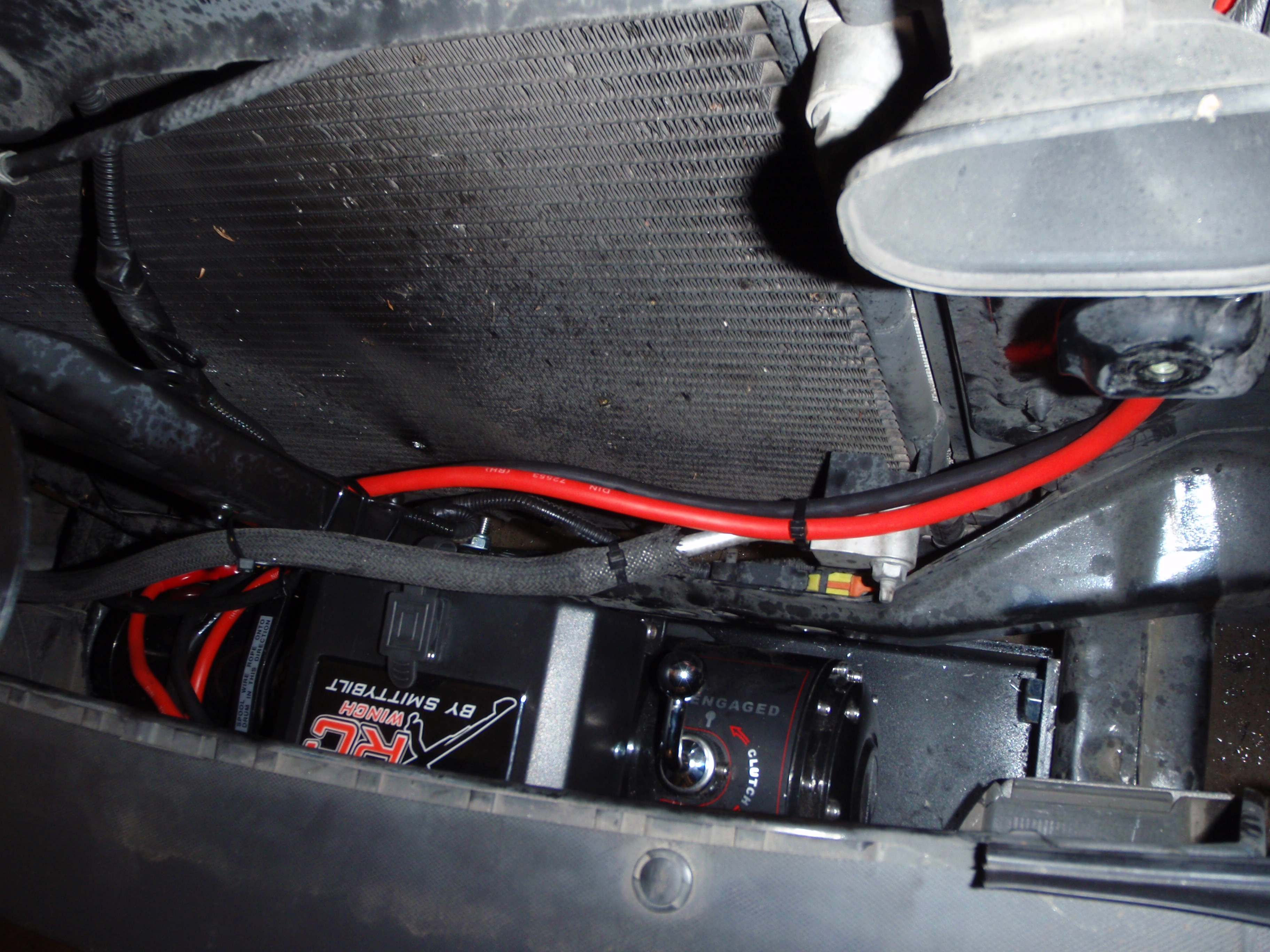

so it's finally where it needs to be
DAMMIT
a bit more progress
dang, if I hadn't told about the drilling the hole in the condensor, it'd look like I knew I was doing
eventually, I'll hinge the license plate... but for now, I just moved it up
