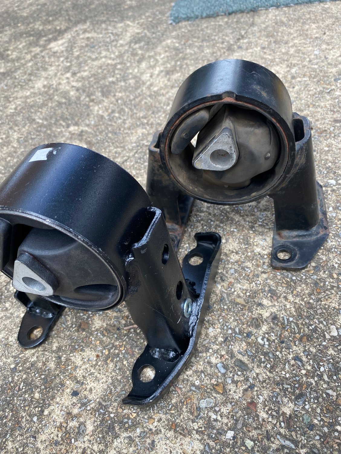

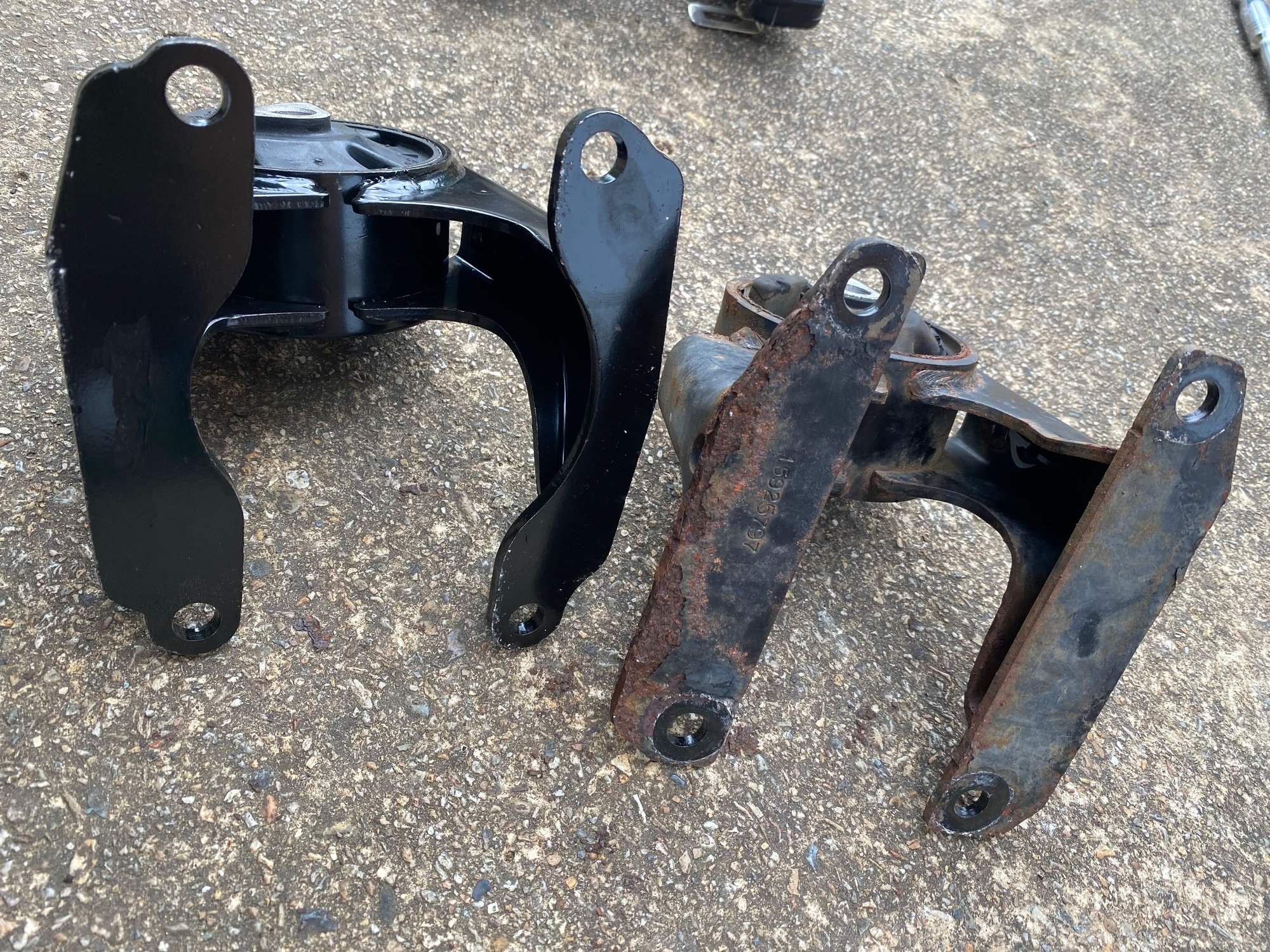

So I ordered the Anchor 3120 & Anchor 3121 Engine Mounts from amazon. They are a little different looking than OEM but they do fit. Hopefully the quality is good. The left side one was missing a thread on top for a wire bracket so I added a M6 nutsert. It took me about 4 hours to change them. I had to remove the knock sensor on the left side to get it out and removed all the bolts from underneath the car. The right hand side was easier to get out. Most of the bolts come undone through the top of the engine bay.

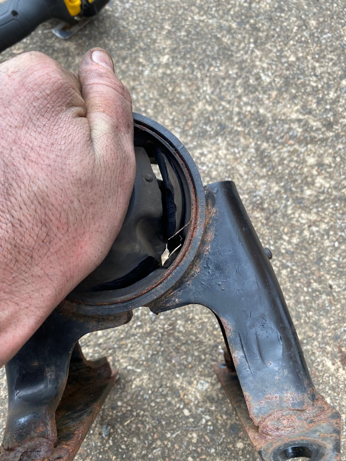

My engine mounts definately needed replacing:

Looks differerent but does fit. Welding seems less than OEM
Left side under exhaust was worst
It was completely cracked
