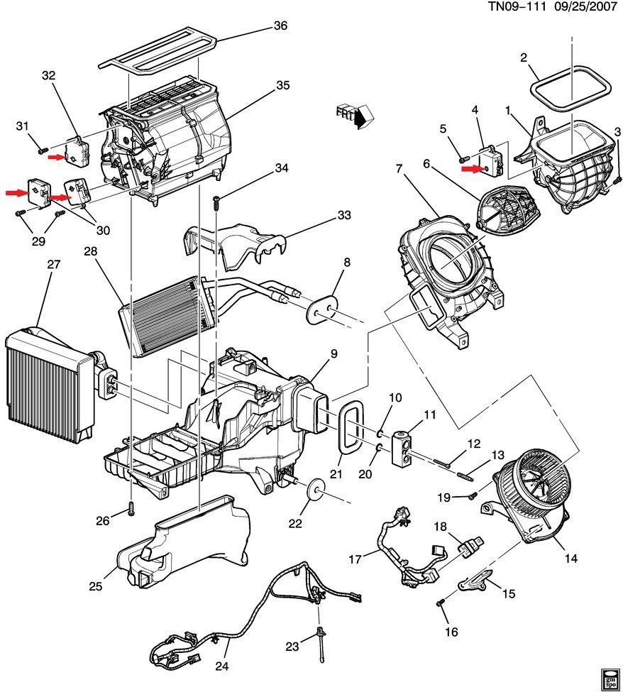

Hello and thanks for any advice on this. I have a 2008 Hummer H3. Having a weird heater problem and hoping you can point me in the right direction. I am getting no heat at all. AC works great. The first thing I did was check coolant - it's full. I then did a heater core flush to make sure it wasn't clogged. I know it's not the thermostat, temperature reads fine, heater hoses getting hot.
The weird part is the selector switch for where the air blows (face, feet, defrost, mix of both) won't do anything except come out thru the vents on the dash. When I move it to floor or defrost it just stays blowing out the dash.. The selector for strength of the blower - low to high - is working but not the selector for where it blows. No heat at all, just cold air. I'm thinking it has to be electrical but would like you all to weigh in. Thanks for the help.

First make sure temp at the heater core hoses inlet and outlet match coolant temp! Check feel/listen to the air mode control actuator #32 when you switch air flow positions. Same with blend door actuators when you switch temp control #30x2. The air inlet actuator (#4) should close when pressing the (air-recirculation) center button, blocking outside air from entering the cabin.

Thank you Hummerz, Temp is the same (heater hoses and Coolant). It must be the Actuators, can't hear anything when moving dials.

Check/clean/reseat connectors/contacts, also tap test the actuators while switching controls. Btw, how much heat does one need in AZ?
