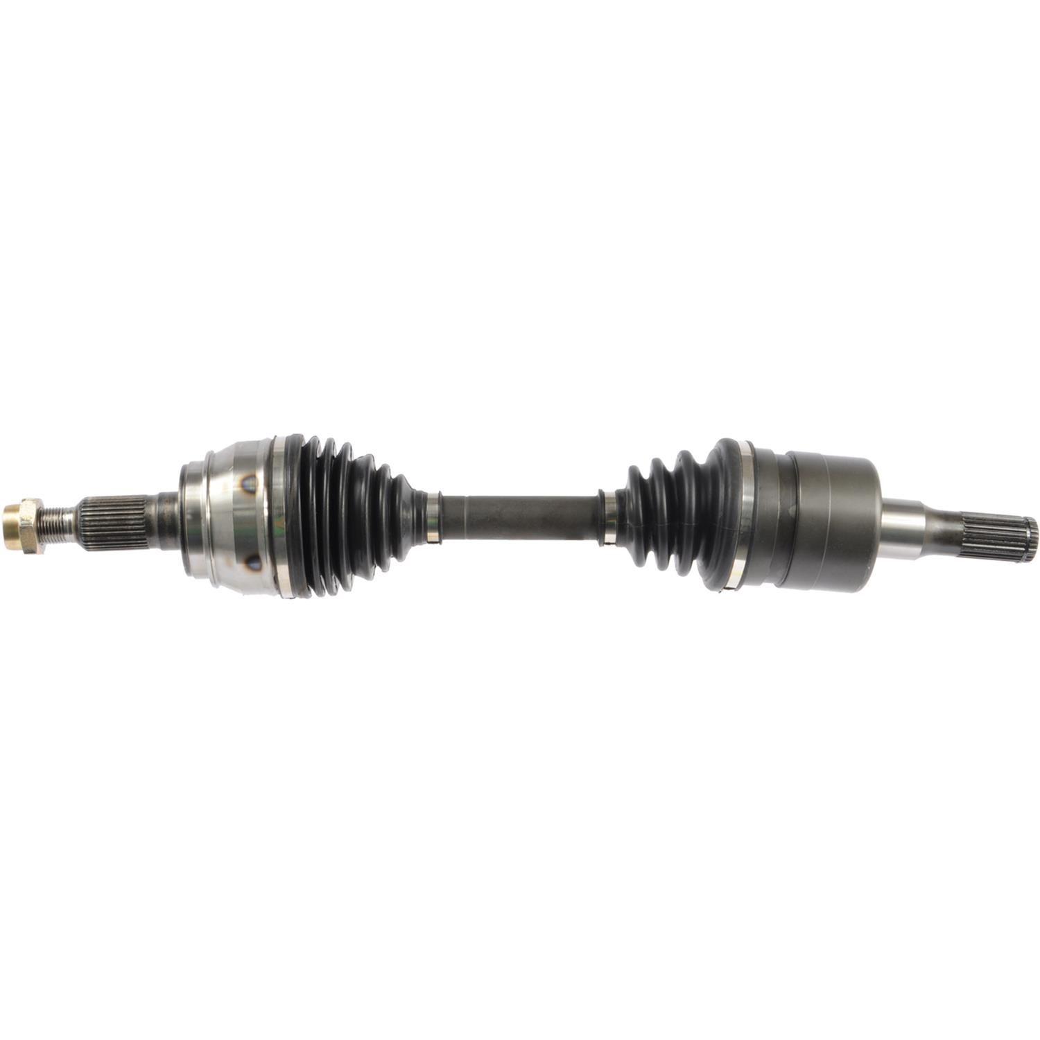

Yes, after 2 gm revisions. 10374204 - 15905106 - 15886012.
Cardone is on top of that!
15886012-661417

Note the extra rib on the outer boot(most common failure), on the Cardone 661417:
