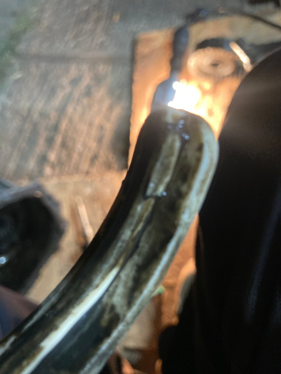

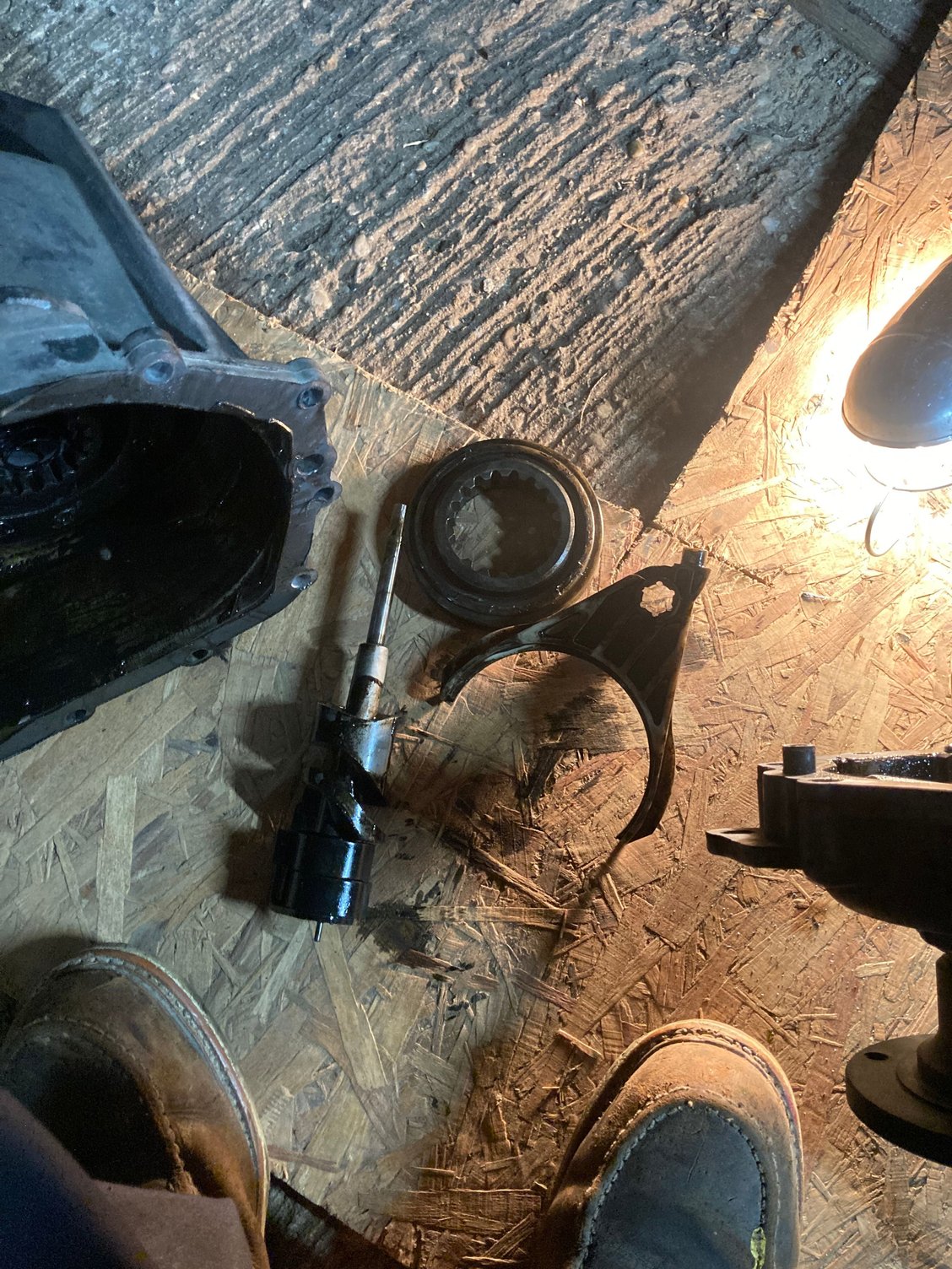

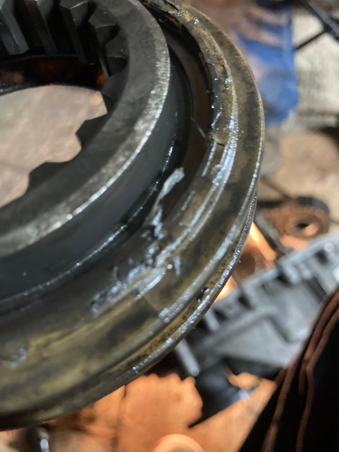

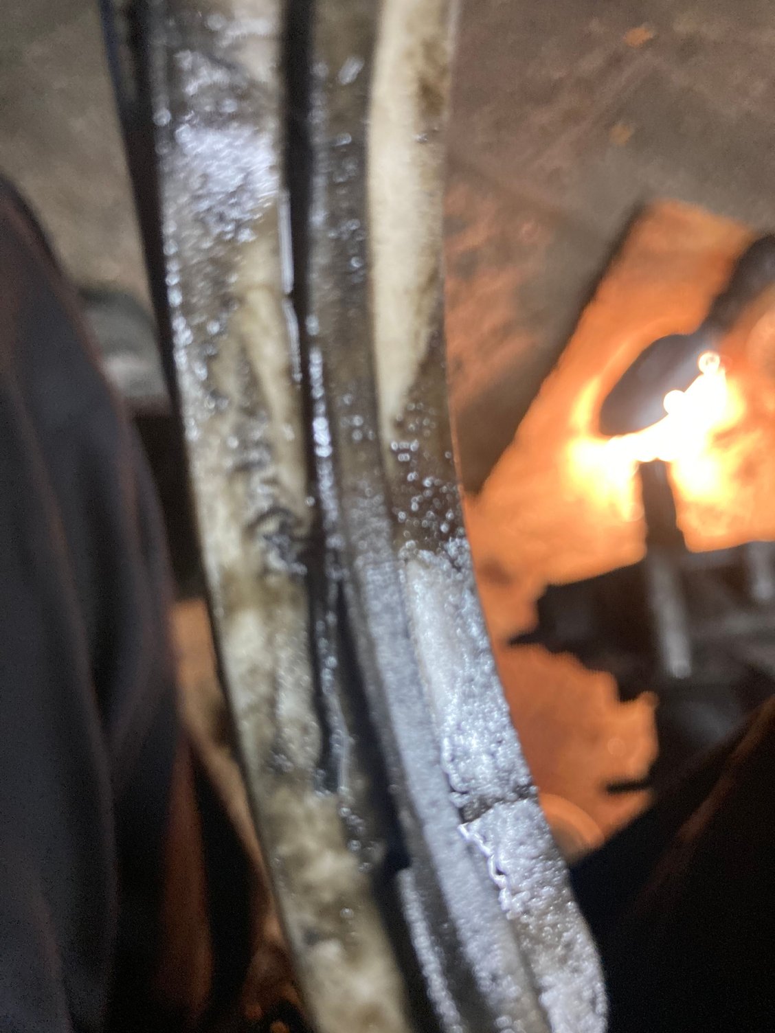

Hey all! I’m relaxing my 2006 H3 shift fork in my tcase. There is a gear that goes with/under the plastic shift fork in the transfer case that seems to have broken off some pieces of it while the shift fork was malfunctioning. I’m trying to find a part number for this gear mechanism so i can replace it while I replace the shift fork. Any ideas on what the part number might be for this??

Welcome to HF. MOVED................. all H3 questions go in the H3 section.
Can't tell from your pics, buy I highly doubt the metal gear did anything other than get pieces of the breaking/melting plastic fork on it, Clean it off and re-use with a new metal fork.
