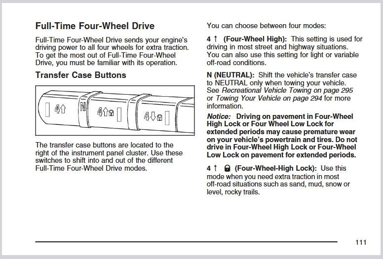

NO other issues with BCM or other electrical that I am aware of. Lights on the transfer case button work as expected - flashes while shifting, then stay illuminated.

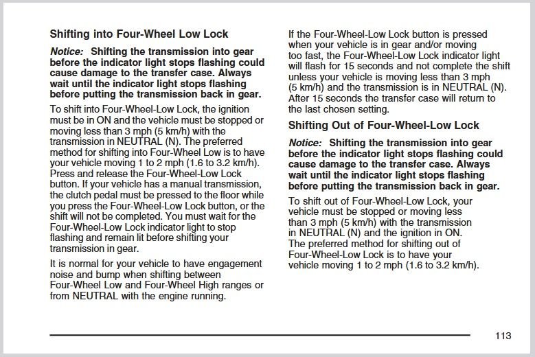

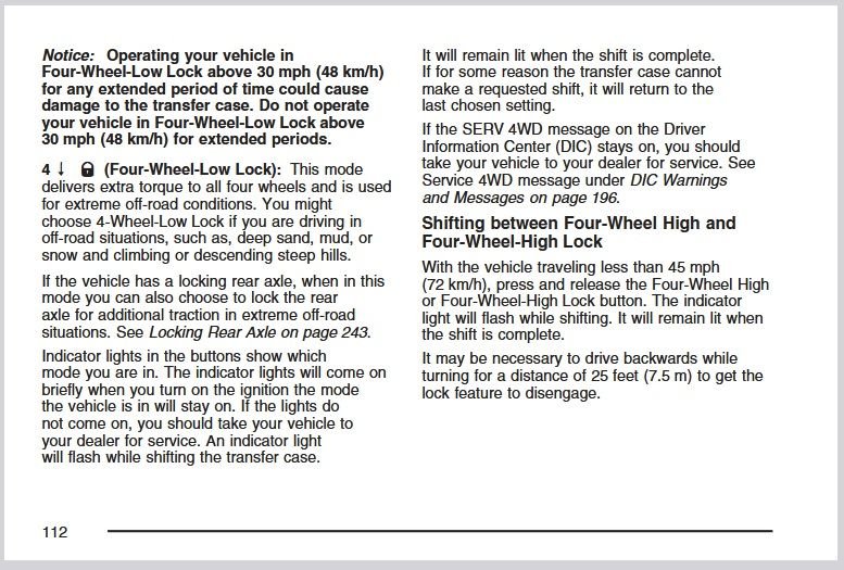

Sorry, I might have been confusing.
The unit (appears) to be shifting fine. But,
When going from 4-HI to 4-HI-LOCK, it does NOT physically LOCK.
When going from 4-HI to 4-LOW-LOCK, it DOES physically lock.
When going back from 4-LOW-LOCK to 4-HI-LOCK, it STAYS locked.
When going from 4-LOW-LOCK to 4-HI to 4-HI, it STAYS locked, until I drive in reverse to get it to disengage.
During all these shifts, the lights operate as normal, with no indication that the case suspects a problem - it believes it is shifting properly.
After typing this up, I guess I have not tried switching from 4-LOW-LOCK to 4-HI-LOCK, then reversing to see if it will disengage. But at this point, I realize I just need to get into my original case and R&R as needed.
