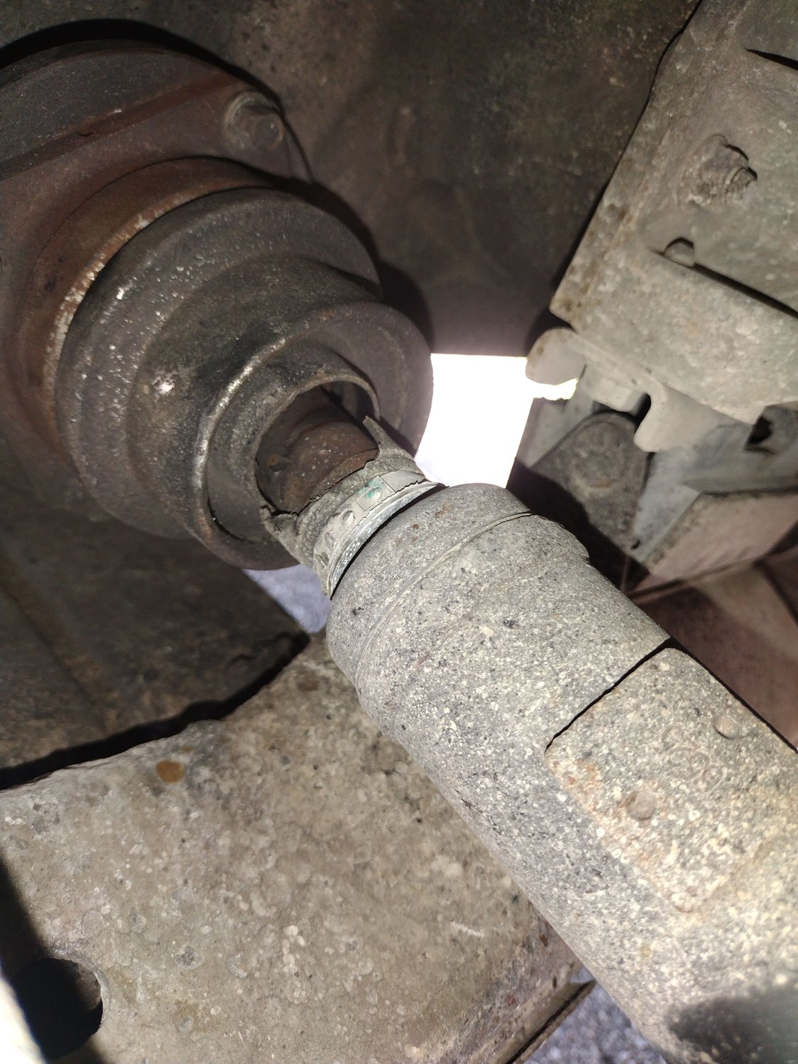

I believe this is my problem 🙄🙄🙄🙄.
Also ty for the quick response and plethora of answers. Everyone whos had anything to do with the post thank u

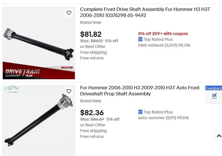

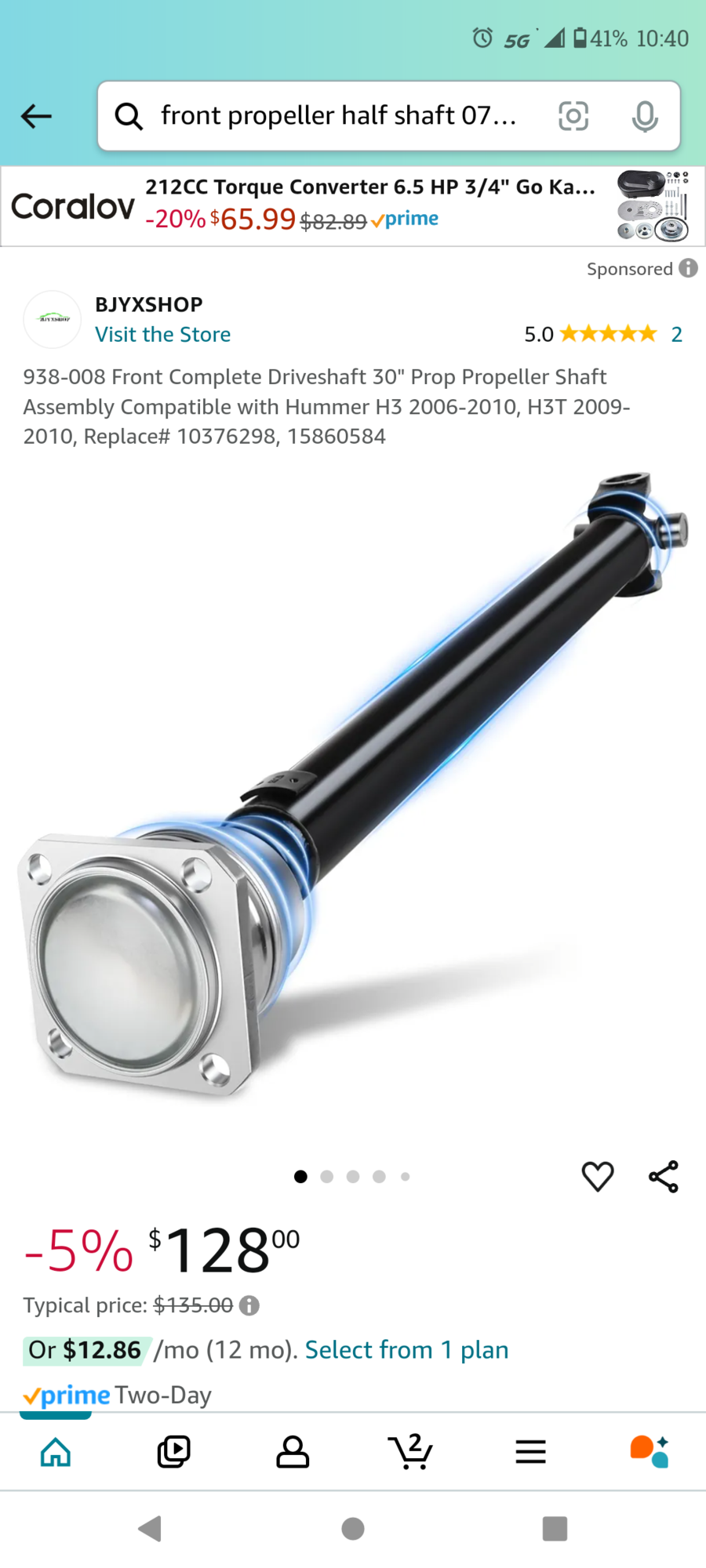

Tgis is what im planning on ordering? It will fit correct? Everywhere else wants 200+
Old Aug 24, 2024 | 10:24 AM
Posts: 9,017
Plenty available on Da'Bay cheaper>>>>> Complete Front Drive Shaft Assembly For Hummer H3
Old Aug 24, 2024 | 10:44 AM
I would not put any of those on my truck. You get what you pay for. Just a spicer U Joint for the front is $33 itself. A Dorman CV joint for the other end is $150. I would rebuild mine instead.
