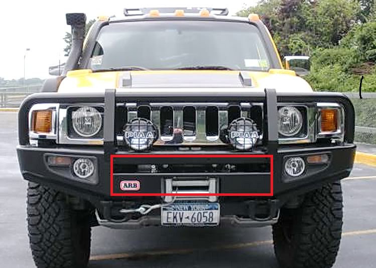

ARB mod

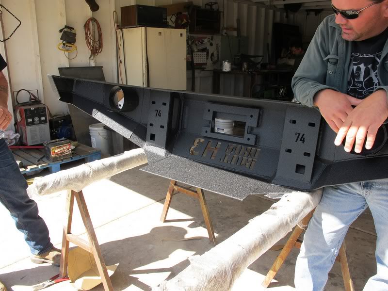

Iron Bull back side. I was thinking of mounting the winch between the H3 frame and opening this up as well as air flow intake below.

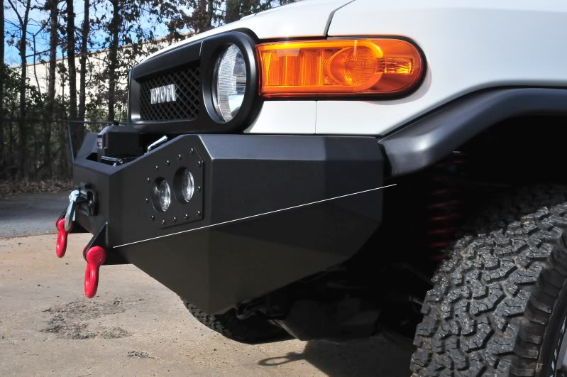

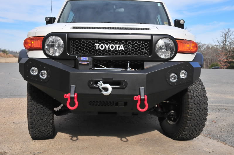

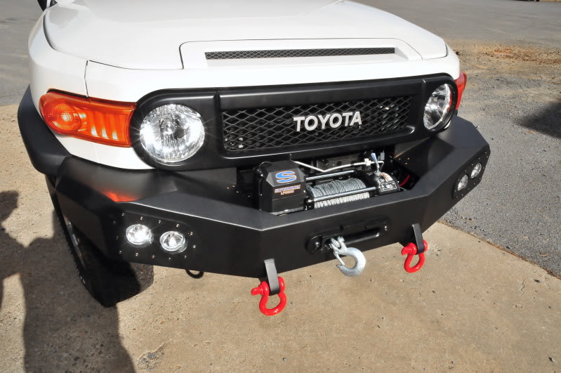

Local design marked by that white line to cut off the added lower apron for an H3.
As it appears the ARB design appearance that has been used on Rovers and Toyotas and now H3 has also done but changing the mounting points.
