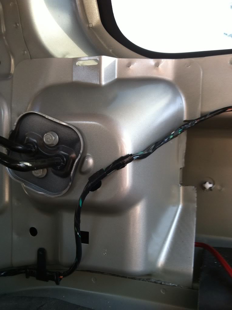

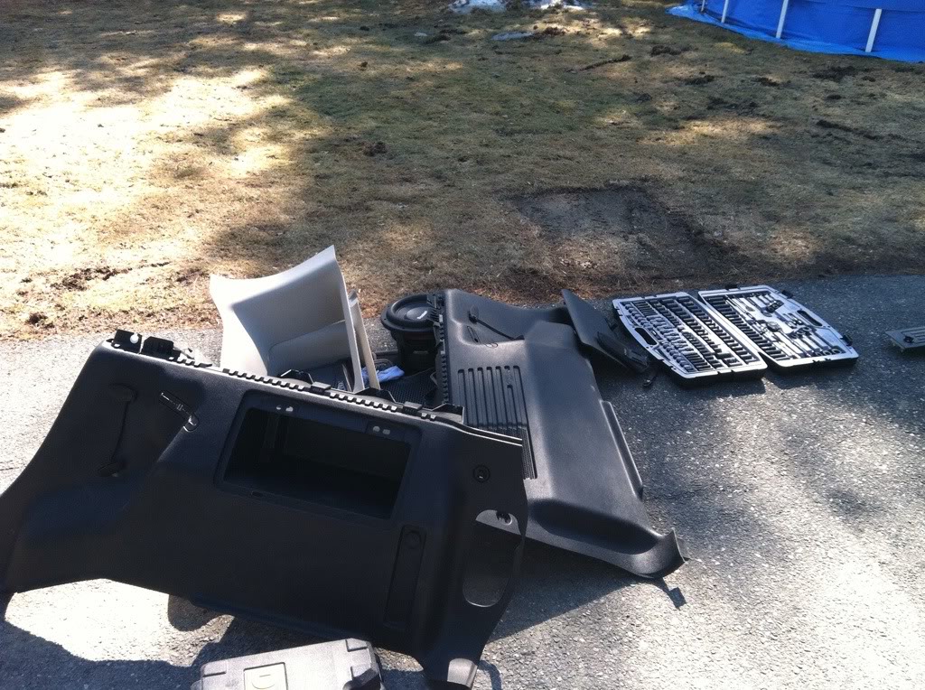

Step 1: Remove some of the plastic out back.

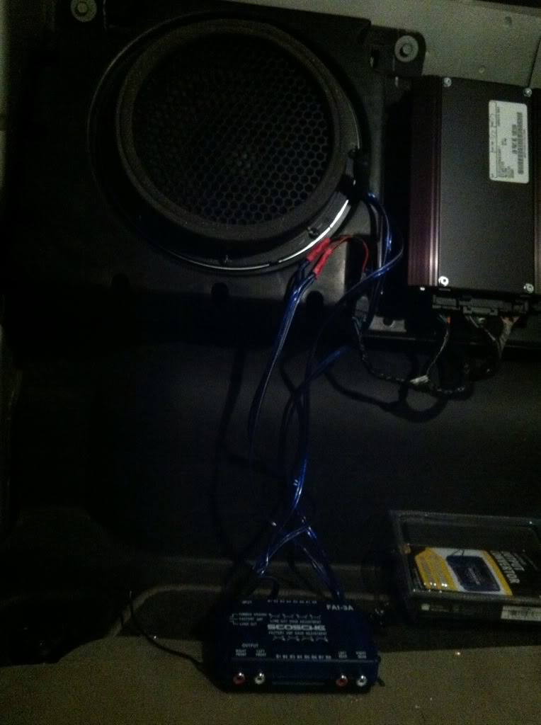

Step 2: You don't need to remove the factory amp and sub, but if you want to do the wiring say, from your couch, it's only 4 bolts.
Step 3: Bridge off the connection going to the sub woofer.
*The RCA cables can be run under the rubber mat.... no chaffing, no rattling*

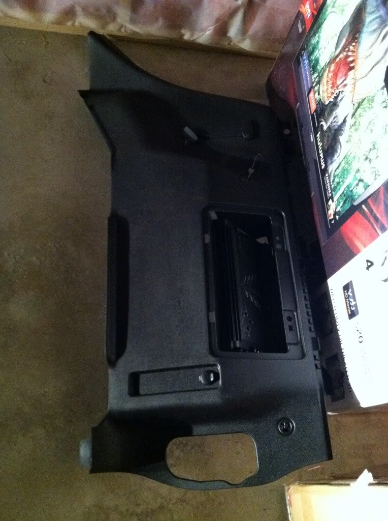

Step 4: Time to cut the plastic cubby hole to fit the new amp. The reason I put the amp in the cubby opposed to behind the cubby is primarily for heat management but also allows for adjusting the gain on the amp.
Should look like this
Step 5: Make adjustments to the metal as needed to allow everything to fit back together. I had to cut in about an inch on the mount for the seat bracket. I just folded the metal back a little, shown here:

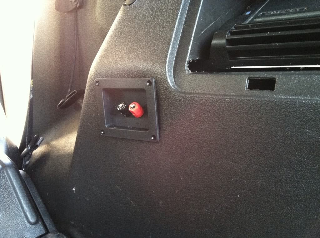

Step 6: Wires. I recommend putting in a normal speaker terminal which can be found at Radio Shack. This makes removing the speakers easy in case you need to carry some cargo. It also keeps the visible wiring nice and tidy. Now is also an okay time to connect the power and ground wires. Be sure to leave a little slack so you can wiggle the panel back into place.
