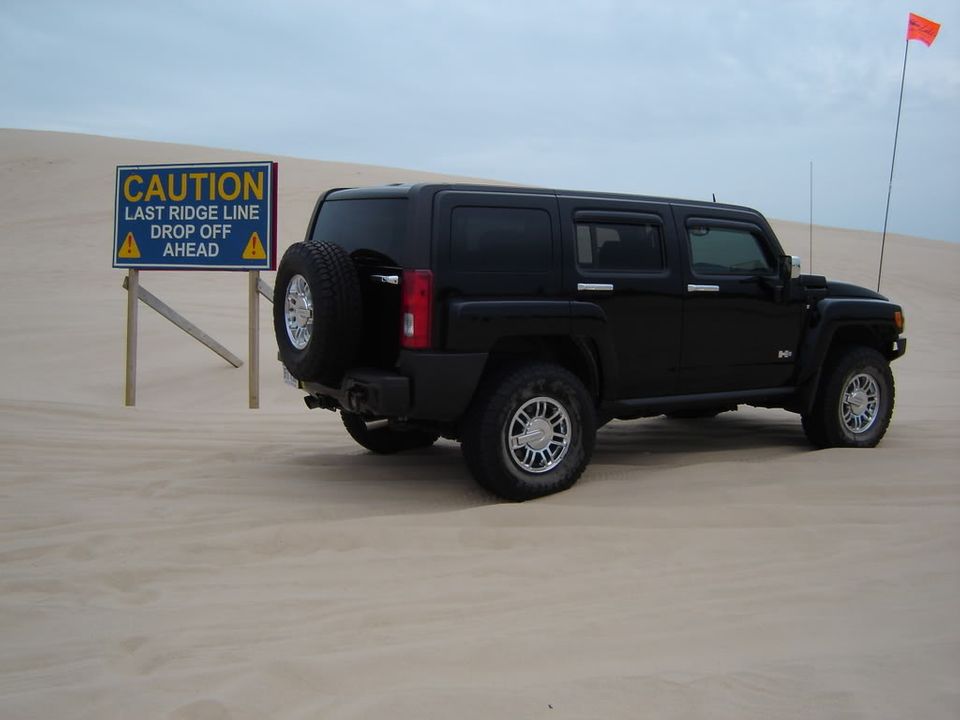

StabiliTrack is what makes the H3 near idiot proof when driving and it does nothing until you NEED it.
TC is turned off with a press of the button. StabiliTrack is turned off by holding the button for a few seconds.
The only time you want to turn that off is when in deep sand, tires deflated to appx 11-15 PSI so you can use unfettered momentum to climb dunes and allow some tire spin.
