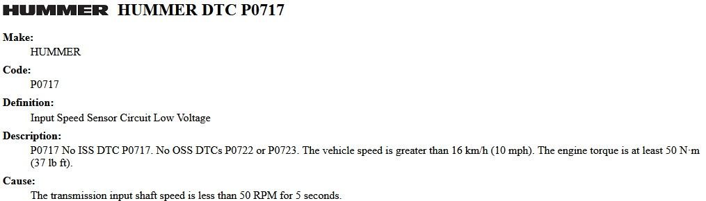

I went ahead and had them replace the input speed sensor that sits on top of the tranny thinking that could solve two issues - the speedometer and the hard shifting/slipping. Dropped it off on Friday and said I would pick up on Wednesday since I was going out of town. Never heard anything so I called Wednesday and was told the sensor did not fix the speedometer so they were looking at the cluster. Didn't hear anything today so I called again and was told the same story.
