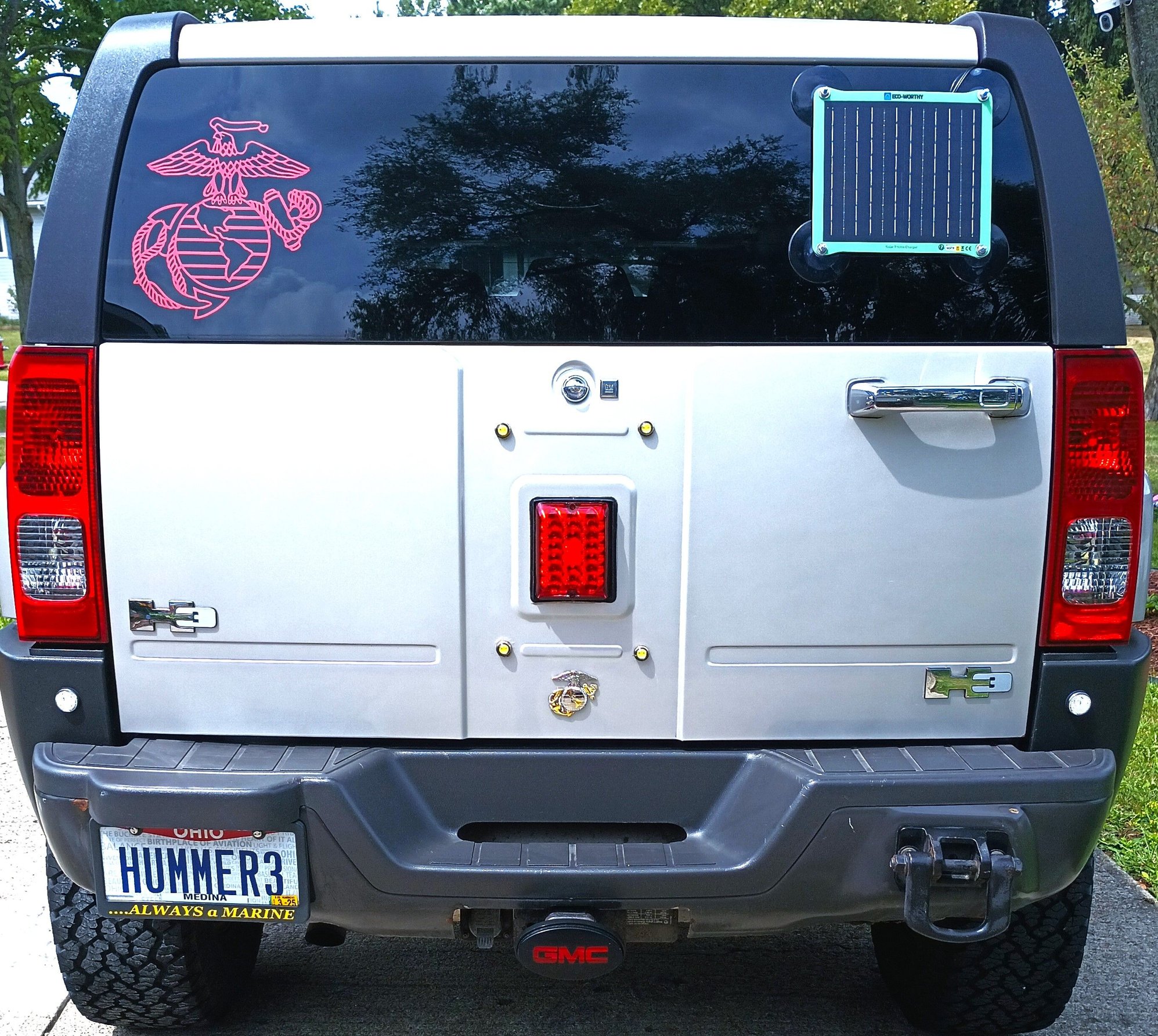

My OEM factory installed spare has a TPMS sensor! Still has the original tire dated 2006(UNUSED) and still planted in my backyard behind a tree! Out of sight-out of mind, yet still holds air in case I ever needed it? I've never lost air in any of my tires+> I get better mpg without carrying a spare-mount-jack-+better view out the rear window!
