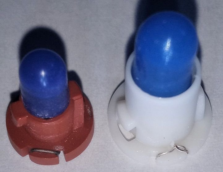

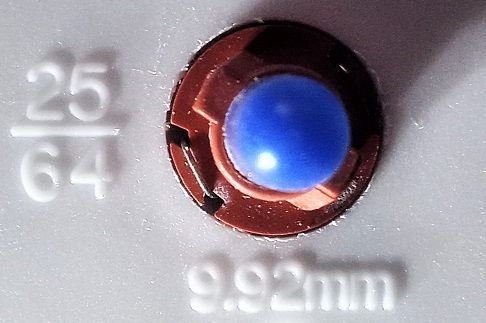

10mm Base diameter>>T4.2 Neo Wedge T4!
T4.7 Neo Wedge T4 = 12mm Wedge Base:
Old Jan 3, 2022 | 05:10 PM
  #22
Posts: 9,047
{{{{{UPDATE}}}}}} Just to check, I ordered the bulbs advertised, THEY ARE T4.7/12MM BASE!
OEM:
20 BULBS I RECEIVED (ADVERTISED 10MM BASE) PACKAGES MARKED 20-12

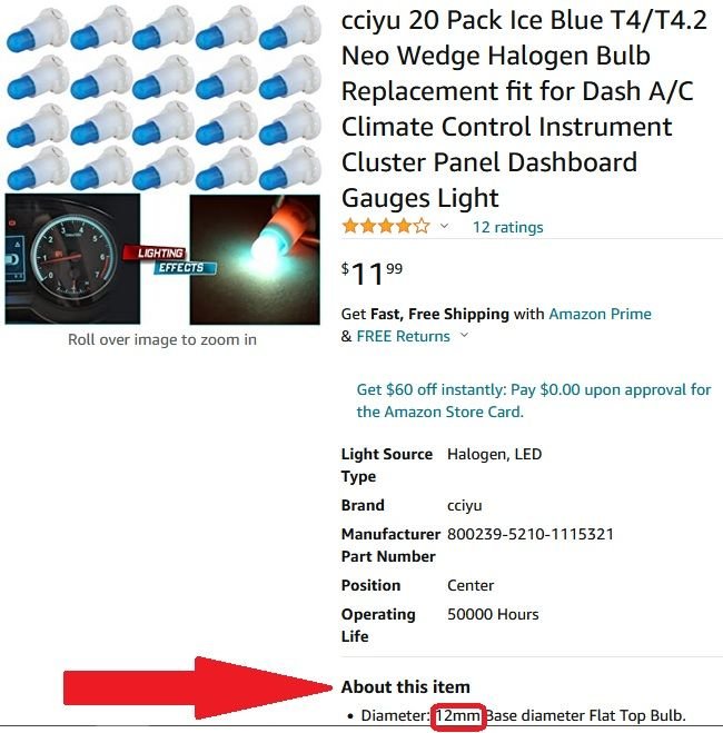

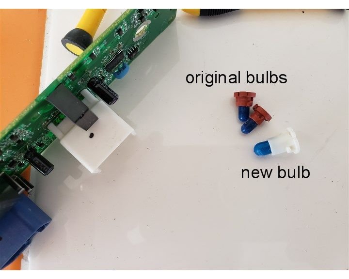

Originally Posted by TAINTER
GM does not list a P/N for the bulb. You have to buy the entire assembly of which the bulbs are out.
Bought these and fit perfectly in the climate control and door switch assemblies. NOT LED.
https://www.amazon.com/cciyu-Halogen...e%2C472&sr=1-8
Well, that didn't work out too well.
I ordered this same set of bulbs that Tainter linked to, but what I got was too big. They do not fit, ugh!
Can anyone offer a link to the correct (smaller) bulb?
Thanks, Greg
Thanks, Greg
Did you see the base size>>> 12mm in the listing?
T4 neo wedge>>>> 10MM

Apparently not.
I've found the correct 10 mm bulbs now and they're on the way.
