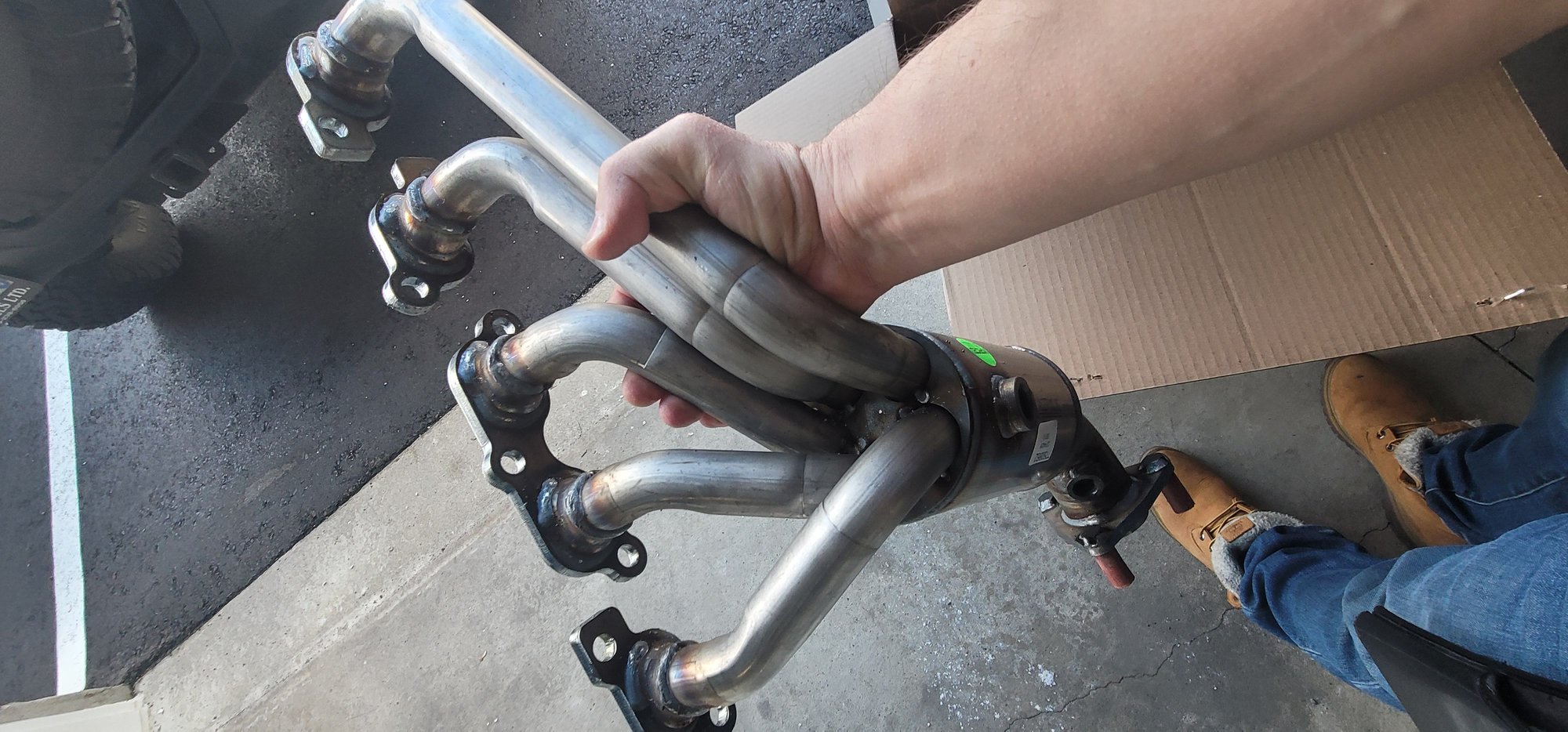

1. The Schultz is basically Magnaflows cheaper header choice.
The welds and bends were not the best quality. Finish was pretty rough.
I spent a few hours grinding and filing off loose burs and even cleaned up the finish on the mounting bracket portion of the headers. You could literally see the imperfections which would lead to exhaust leaks IMO. Lastly, I did a quick hand polishing and it looked much more appealing!

Header our of box
Post cleaned and polished
