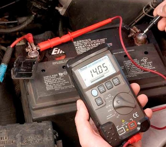

Put a meter on your battery, should be @12.5v+resting. While keeping the meter attached(clamps or stick probes in terminals) turn off all accessories and start it up. You should get 15v+ on startup, then after a few minutes, should drop to 13.5v.
Post the results.
Post the results.
resting is 12.77
when I start it it’s 15.38
and after few mins it fluctuate between 13.43 to 13.53 then to to 13.50 for few seconds then fluctuate a little

Fluctuate a little? Run for a few more minutes, turn on all accessories, looking for the low end reading.
Also, scan and post the codes.
with all accessories are on and headlight and all I am getting the lowest is 14.35 for like a sec then it go up again and fluctuate and highest is 14.47 they fluctuate in seconds
and scanned for codes. No codes no check engine light
