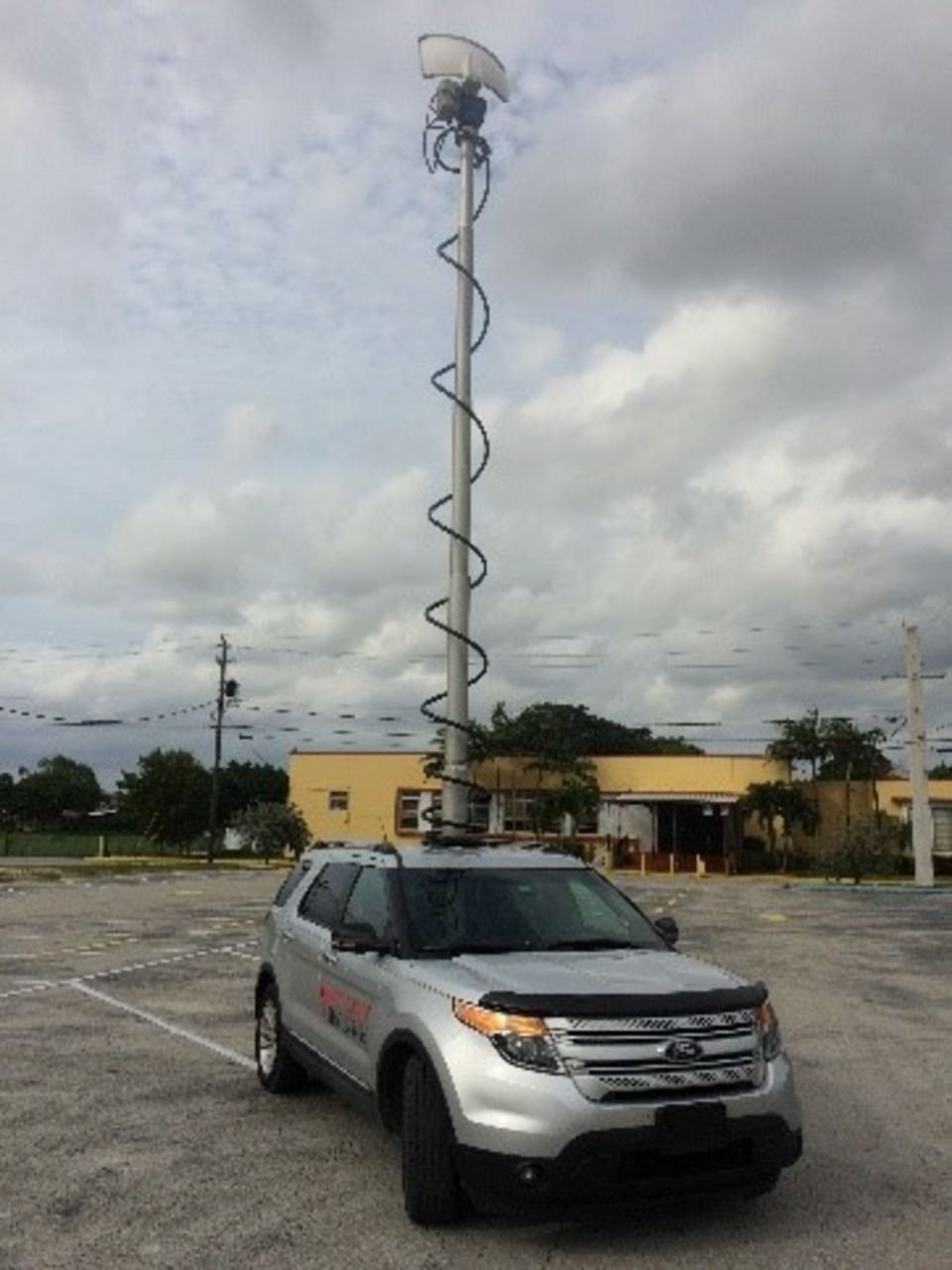

Like this:

is that the Will-Burt elevation solution pneumatic non-locking low-profile telescoping mast solution? their pretty good no maintenance required.
