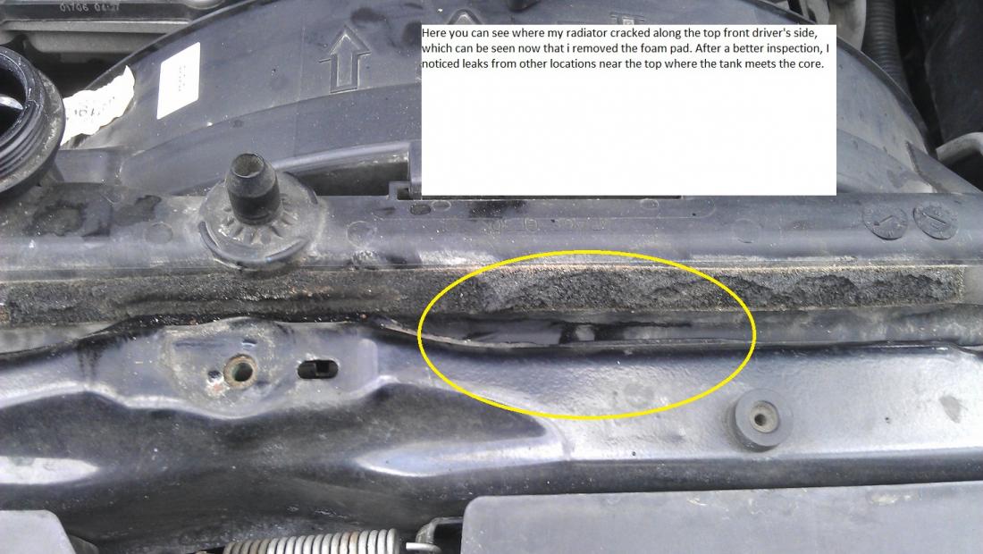

After monitoring this thread for a few years and waiting for the day mine cracked, it has finally happened. I have a 2006 H3 and at 57k miles the radiator has fractured across the top near the seam.
The leak is luckily slow, with only a few splatter marks across the hood, which allowed me to finish a hour and a half drive back home.

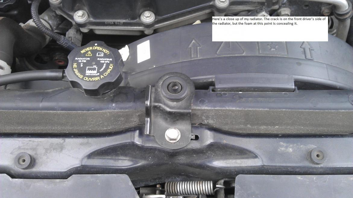

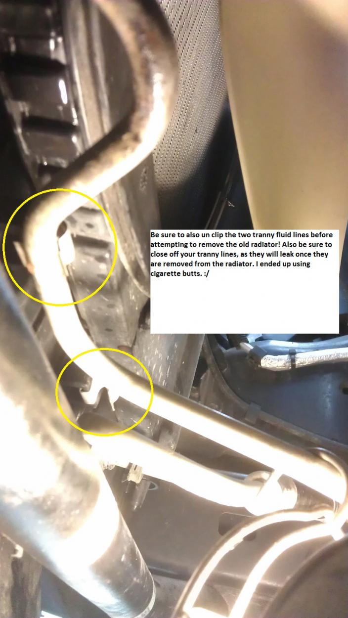

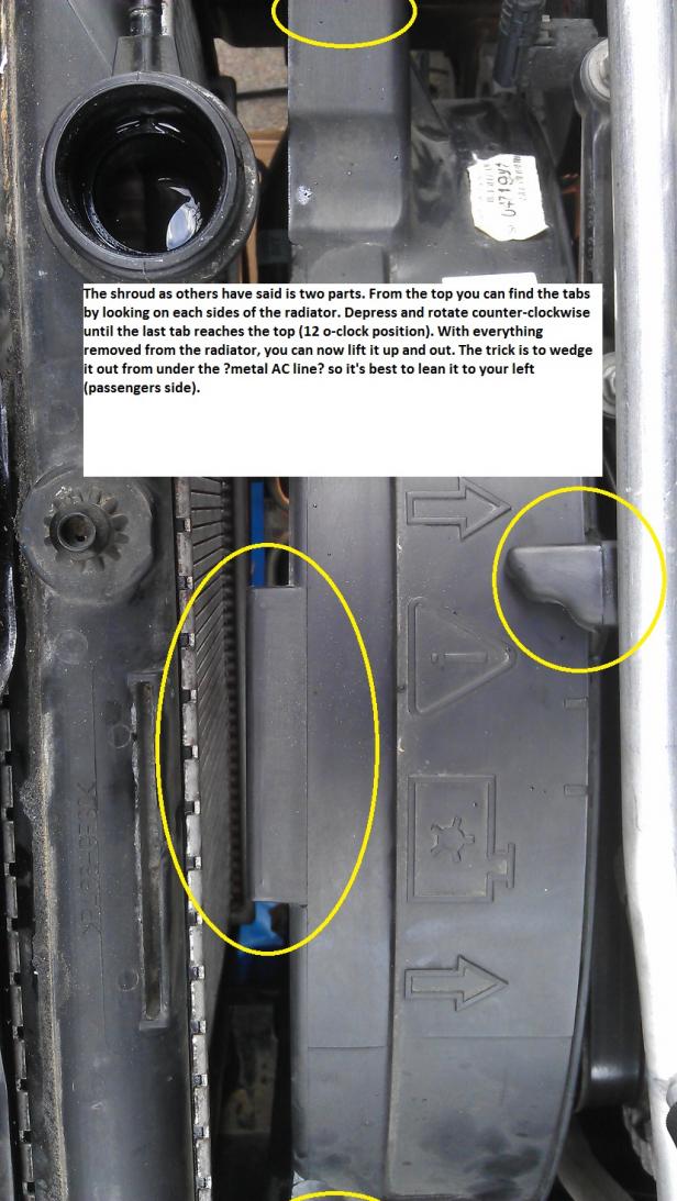

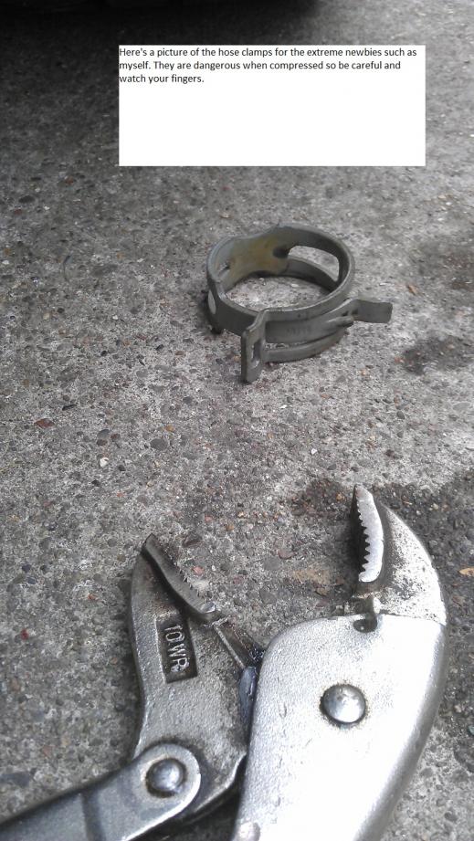

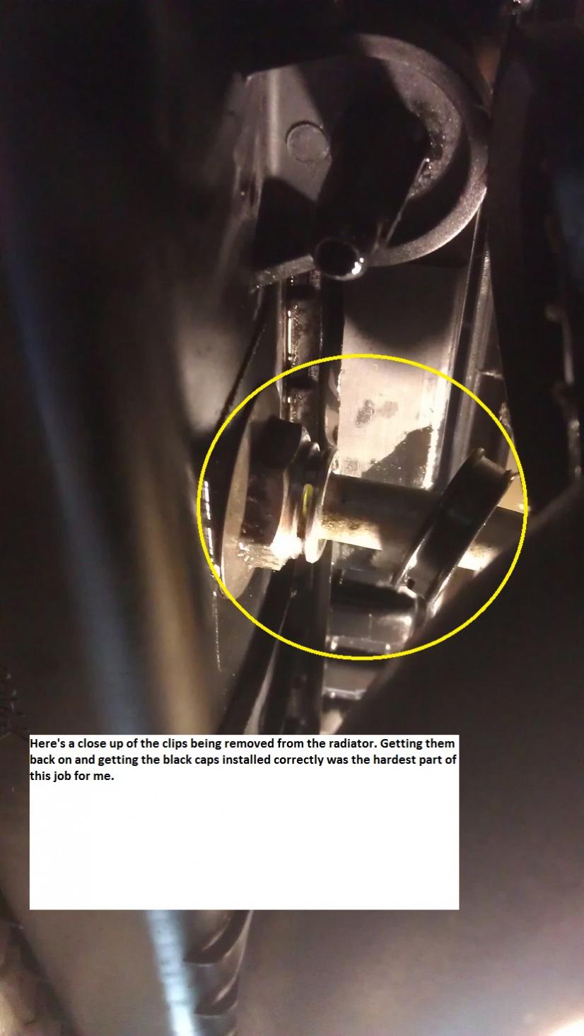

Here are the pictures I took, with some very newbie-styled literature to go with it. I'm not a mechanic and this was my first time ever doing anything other than brakes, tires, oil changes on my H3. The tools I used was a thin flathead, vise grips, 10mm and 13mm wrench, and a small phillips screwdriver. I went entirely off of previous user's instructions and I thank you all for that guidance. I'm posting these pictures in hopes that it will help aid other newbie mechanics such as myself, since i'm assuming the older H3's will be having this issue more often.
Attached Thumbnails Read If Your H3 Radiator Has Cracked or Leaked-imag1600.2.jpg   Read If Your H3 Radiator Has Cracked or Leaked-imag1601.2.jpg   Read If Your H3 Radiator Has Cracked or Leaked-imag1602.2.jpg   Read If Your H3 Radiator Has Cracked or Leaked-imag1603.2.jpg   Read If Your H3 Radiator Has Cracked or Leaked-imag1604.2.jpg

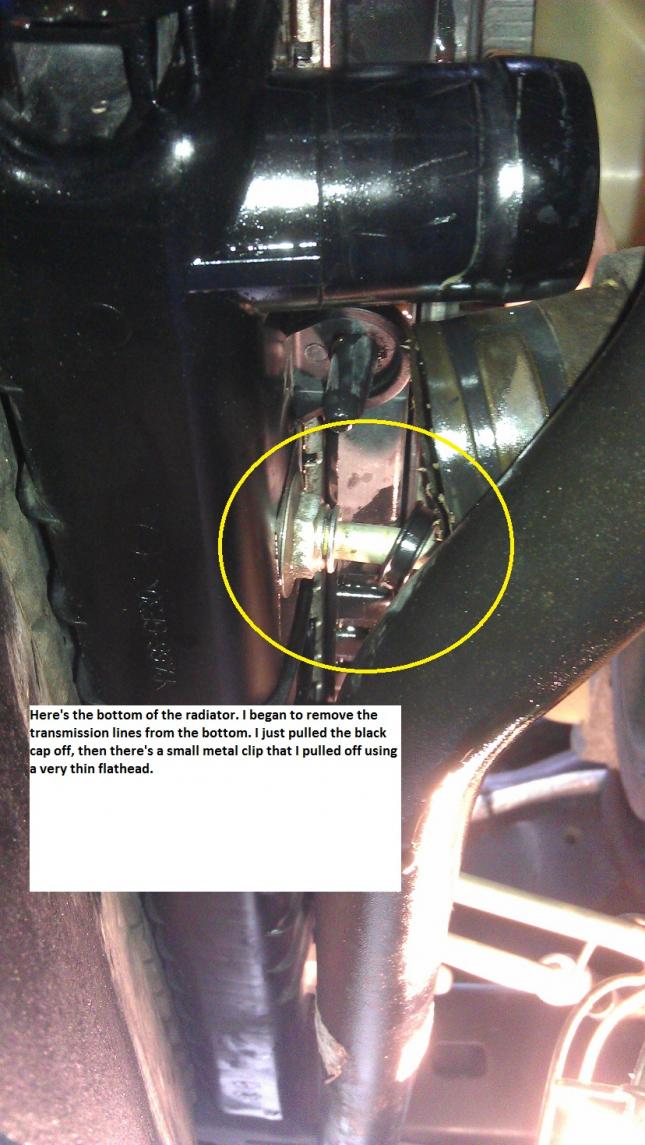

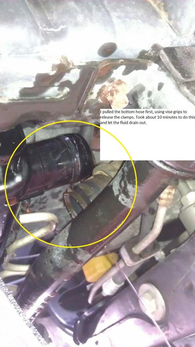

Here are more pictures with info regarding the radiator replacement.
